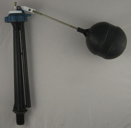

I haven't had negatives for bowl wash on Dalton, just fill valve problems.
They use the cheap Coast ballcock that has the rod and float.
