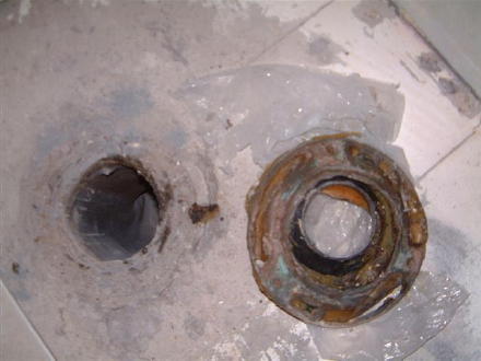

Thank you both for replying......I can use all the help I can get......I would send you pictures if I could figure out how to....the flange is completely broken off the floor.......I have no idea what the pipe is......but the closet flange is some kind of metal and its broken.....it looks like it was never bolted just cemented in.........I went to home depot and bought a new closet flange and bolts as it has holes for bolts on it.....its brass.......they only had brass and looked like pvc plastic...and I didn't think plastic would be good....you may know something I don't on that.......just seems to me the brass metal would be better......the lip on the new flange is about an inch and half deep and pretty thin about 1/8 inch thick I would say........so I figured I would have to dig out that deep at least to set it in.......but was wondering if I needed to cement it again before I bolt it......what is best to use for digging out old cement if the hammer drill is the least it sounds like it may not be the best to use.....I used a special cement saw that I attached to my craftsman all in one for my tile grout removal and it cut right through it......could I use the same thing to do the cement? ..its great for cutting a straight line....I don't know how easy the circle is going to be........I have the sears cutting tool and I just put the saw on it and removed the grout.....it was not fun.......but I got it done....and I had to vacuum up the entire room afterwards it went everywhere.....but I got it out.....or should I rent a tool that is made for that at home depot?...I have a drill if there is an attachment that works on it for cement and I have all kinds of attachments for the cutting tool.......it has a bit for concrete and is a circular saw/router/free hand scroll saw and its called the all in one cutting tool so I could set it to cut a circle but I don't know if that is best....it doesn't look like it would cut deep enough....I think renting a tool would be lots less than hiring a plumber ......so I am open to that.....when you get a chance let me know what you think.......thanks again.

What is the inside diameter of the pipe that we are dealing with? We have different options depending on pipe size. The mechanical CI flange will work well if all of the old flange is gone and you have 4" (which is probably if it is cast). This fits inside and tightens against the walls of the 4" to secure it. ALL flanges, no matter what type, will need to be anchored to the concrete, so you always need to be careful that you do not take out too much concrete around the pipe or you will have nothing to anchor to. Try to identify the type of material we are dealing with too. Like Lonny said, the repair and type of flange you need depend on the material we are working with.

To post pictures directly here in this forum without providing a link, use the icon in the message composing area. You can "Insert Image" or "Insert Hyperlink".
Granny2HWBLGJJ
toilet flange pic
ok I think I got it attached......when I click on the insert picture it just gives me a http script......it measures 4 inches

do you mean the flange goes down in the pipe rather than on the outside of it so you don't have to dig the concrete out????? :confused:

Yes! Let's put a smiley face on that one! :D
They make a flange that you can insert inside the 4" pipe and it has tighteners that will tighten it to the existing pipe. The flange will still need to be anchored to the concrete floor with concrete anchors of some kind, but that is generally fairly easy.

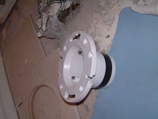

ok this is what they tell me is the CI mechanical flange .....it looks plastic but its a hard plastic.....is this the critter I need? there was a plumber at the supply place that said I needed to file down the top of the pipe to make sure no lead was sticking up.....I don't think any is sticking up but there is excess concrete that looks like what the old one was seated in.....if this is the right thing I will go ahead and put my tile in and then install it.........thanks for all your help ........you have just been super :)

That's the critter. There is always alot of discussion about the pros and cons of a metal flange (rusts out) or a plastic flange (breaks easier). If everyone preferred one kind, there would only be one kind. This should be just fine. A concrete bit with some concrete anchors to secure the flange to the concrete and you're set.
