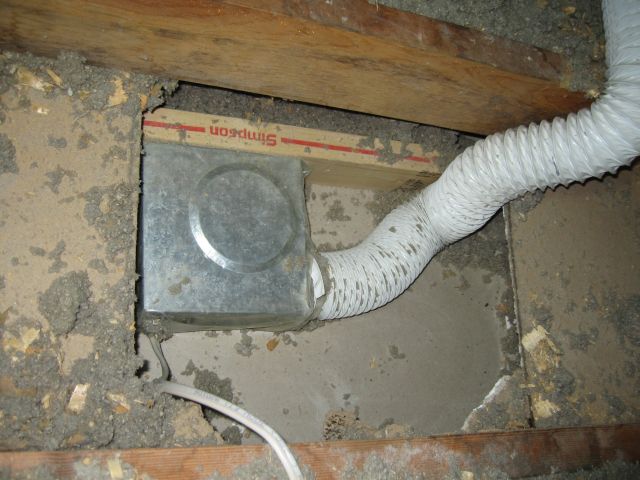

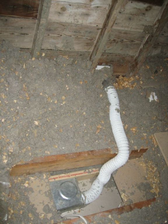

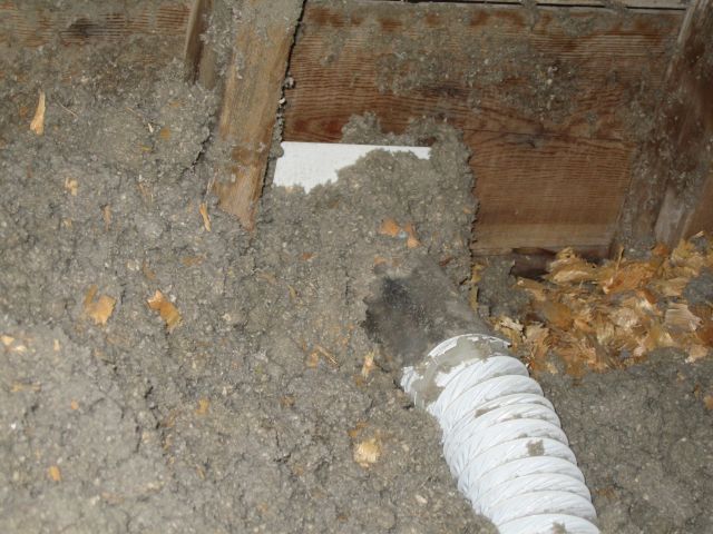

    I'm remodeling my bathroom and one of the first things I'll be replacing is the exhaust fan. My home is a 1 story home and I have a stair case up to the attic which is just insulation and about 6' tall in the middle. Today I went up there and was surprised to find that I have a double ceiling in the bathroom area. Should I pull the ceiling and add vapor barrier or should I just leave it? Secondly I was going to use a rigid line for my exhaust, should I run it straight up/over/and through or over/up/across and through or should I just buy a flex line?

    what do people do in your area? Is it humid enough to justify vapor barriers in bathroom ceilings? I'd not put a vapor barrier in. I'd put a few dollars into a "rigid" exhaust line, one with smooth sides. Not the one shown in these 3 pictures. I'd put a lot of money into a quiet fan on a variable speed controller; that's because I need the quiet.

    I'm not sure that you understand what I mean by a double ceiling. If you look at picture fan2 you will see a 2x4 with red writing on it. That is the new ceiling (the lower ceiling). Above that there is a gap of about 6" and then a 2x8. If you look closely at the bottom of the 2x8 you'll see that a 2'x2' opening was cut into it to make room for the ceiling fan. So the order is bathroom drywall, 2x4, 6" gap, drywall, 2x8. I hope this makes more sense.

    Unless that condensation was especially concentrated around the area of the fan, I would doubt your removal of insulation from around the fan was the cause of that unusually high level of condensation. More that likely, that was simply the result of back-to-back showers and not previously noticed by yourself.
    If that was my own project, I believe I would simply install the rigid vent line and close everthing back up as it was ... and after checking to be sure the wiring to the fan is the type that can be safely buried in insulation.
    I would not install any kind of vapor barrier, and I would consider a dehumidistat (along with an over-ride and/or timer switch for removal of odors, if you like) to control the fan and humidity in that bathroom.
    Removing the lower ceiling could be a good idea if you want/need the extra ceiling height, but that present void is a dead-air space that actually adds a little to your overall insulation.

    OK then you may have enough insulation, if it goes back in the hole, the hole gets sealed, and then more insulation goes back on top of that, to the level of the 2x8s. A lot of air can leak out there if you don't tape it airtight. From what I have read about your standards as a homeowner renovator, I would still add a layer of foil. On top. I don't see any reason to undo anything.
