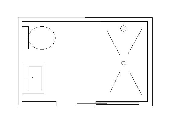

Pocket door wall sturdy enough to mount glass shower panel?
I am remodeling my master bath and would like to use a 3/8" glass shower door. It would have a door and a fixed panel, both combined totaling about 60". The glass door portion would mount to a wall to the left which would have a stud behind it in the required location and therefore not be a problem. The fixed panel would mount to the curb underneath and a perpendicular wall to the right which would have a pocket door sliding into it... and therefore not a traditional stud to secure the fixed glass panel to.
There is a pic attached (assuming I did it right :D ) so above makes more sense.
So my question is, will the framework of the pocket door wall be sturdy enough to support the weight of the glass panel? It seems to me that if I use a U channel mount for the panel, the force would be distributed over a larger area, and possibly work better than smaller brackets.

The fixed panel doesn't need anywhere near the support as does the heavy swinging one, especially if it doesn't have a stop that would get banged by the door. All the weight would be on the curb. The hassle might be if that wall flexed, but depending on whether it was attached with a channel or brackets it may not be a big deal. You might want to check with the manufacturer and ask their recommendations. Will the glass be going to the ceiling or stop short?

Thanks for the reply. What you said makes sense. I was planning on having the glass stop short of the ceiling, which I assume will potentially cause more stress on the wall if we bump the panel when stepping in and out. Sounds like as long as nothing is bumping into the panel there shouldn't be a problem.

1. If you want a watertight seal, you will have to use a "U" channel anyway.
2. If it is like most door/panels, there will be a top rail integrating everything which will minimize any stresses.

tile on pocket door framed wall
Jadnashua,
I noticed you mentioned that the pocket door framed wall wouldn't be able to support the weight of a tiled wall too well. I was looking into using the Schluter-Kerdi process for tiling my shower. Are you familiar with this process? There would be substantially less weight involved... do you or anyone think this would work? My bathroom is too tight to build the wall out further as your described. Please see my diagram earlier in this thread to better understand my layout.

The hassle with framing a pocket door AND retaining the standard wall thickness, is that the small supports need to be installed on their wide side, rather than having say a 2x4's long edge between the walls. Otherwise, there'd be no room for the door! This gives much less strength, since it is across the narrow width of the support. Johnson uses moderately heavy gauge metal wrapped wood studs as opposed to those I saw on a Stanley pocket door, which were just plain pine 1x3 wood. The Johnson metal wrapped studs are much stronger and almost immune to warping. Your tiled wall would be supported by these relatively flimsy supports. On mine, Instead of using their studs, I built the wall out using standard 2x4's. This made that wall thicker, but also made for a standard wall both in thickness for the plumbing, and for strength.
For tile, you don't want any chance of movement, it will either crack the tile or the grout. Once you get tile on a thick piece of Wedi, it would probably work fine, but a strong wall and a pocket door often don't go in the same picture. For less money, and about the same thickness, you could do what I did. The Wedi board is a good product, but you pay a lot for shipping it from Europe to the US distributor.

Alvarto said:
... a door and a fixed panel .... The fixed panel would mount to the curb underneath and a perpendicular wall to the right which would have a pocket door sliding into it ....
you don't need "support". The glass panel is so strong all by itself that it will help keep the wall strong! At least, each perpendicular piece at that 90 degree angle will strengthen the other one. I siliconed a glass panel onto a painted drywall surface that has flimsy 26 gauge metal studs behind it. No channel ! Looks good.

A panel of tempered glass, siliconed or fixed anyhow, will give a rigid perpendicular support to a wall that is already strong enough to hold itself up. A tempered glass panel is very rigid on its edge. That gives support to make wall more rigid. It will help the wall, and not "need" the wall for support.
True, if someone kicks the wall and if there is a pocket door there, there is less support inside that wall than with a traditional stud structure. If the wall is tiled, a good kick will start a few cracks happening.
Whether or not cracks will happen with no such impact force, is not ascertainable in advance. I wouldn't want to influence you to build it too strong or too weak, so I'll encourage you to use your own judgement.
david
It's hard to press against a tiled wall built on 2x4 with cbu on it hard enough to cause the tile to crack or the grout to give up the ghost. You won't have anywhere near that strength with it over a pocket door frame. So, do what you can to strengthen it to preclude that from happening. Tile really does stiffen up the wall, but...

I have minimal DIY skills which I am developing one step at a time. So to build my first tiled shower, only to take a chance of having to rebuild it down the road, is a chance I don't want to take. It is foreseeable that someone could lose their balance in the shower, hit the wall, and now I've got another project on my hands.
Given my bathroom is only 5' deep to begin with, I'd rather not build the wall further out, although from a structural perspective it is a good idea. I guess I'll just stick with the traditional door. There is room for it to swing, but I just thought it would be more slick having it hidden when it's open.
