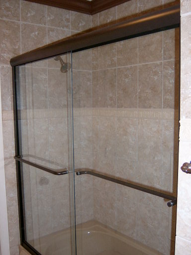

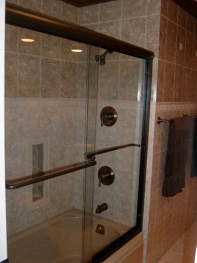

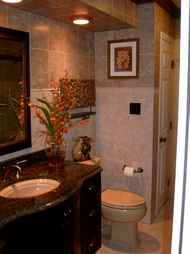

    Default My workaround
    It's been awhile since I posted this.
    While plumbing my second bathroom, I realized that it's really just the showers that I wanted additional hot water for. So, I ended up installing two shower fixtures in the second bath...one connected to one hot water heater and the other connected to the second. Worked out just fine.
    Attached are some finished photos of the job. I really like having the two shower heads. My original plan was that it would be nice to have a second one in case I ran out of hot water on the first water heater. Turns out I just like to shower with both going. I don't shower at the same time as my wife so it's not an issue.
