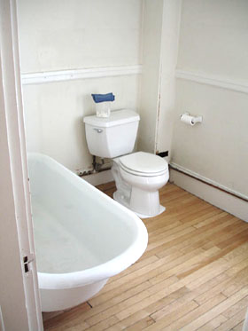

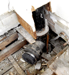

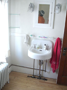

Here are some photos of the space.
Here's the old bathroom (now removed) and the plumbing conundrum. Note boxed-in corner for stack, and medicine cabinet we're trying not to move.
Also, we're trying to do this whole reno for under $1000. Have bought nice Kohler cast iron tub, pedestal sink, facucets, tile, etc and so far within budget. But there's no budget for fancy corner tubs or anything like that.

I would consider the following approach, but I don't have enough information to know how to specify the details.
This suggestion is a civil engineering solution to accommodate the plumbing.
Consider running the line from the toilet to the stack in a straight line, if you can get enough slope that way. Disregard the joist issue as will be described below. The cost of copper is probably small compared to the rest of the cost if dimensions are an issue in achieving the required slope. However, you aren't going to gain a lot over PVC.
You might be able to gain toilet height with a spacer to raise the toilet. You will go in the direction of an "ADA height" toilet without affecting the floor match to the room at the doorway.
Then, design a structure to support the floor.
It would mean doubling or tripling the joists on the left of the stack and right of the toilet. Then headers, parallel to and on each side of the pipe from toilet to stack, would be attached to those doubled joists with hangers. The cut joists would be attached to the headers with hangers.
Those doublers must be extended to the support points, or someone needs to pay attention to the bearing and shear loads. I would want to see the plan of the structure out to the supports on all four sides of the bathroom.
You need to be sure that you allow for shrinkage of the new material relative to the old. It should be kiln dried stock or you can dry it before intsallation. I would not plan on putting ceramic tile on the floor for a couple of years.
You will probably need access to the floor structure from below, out to the support areas.

ok, after seeing the pictures i see the stack is in the corner, so the tub would be farther away from the window wall and that much closer to the door. Not a big problem. Having an 8" ledge there is good.
Is the custom medicine cabinet shown in the drawing? Or is that the pedestal sink?
Which model tub did you get? Rounded or square corners?
