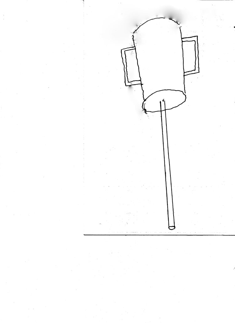

    The best hammer I have used is a piece of 6" pipe filled with lead. The pipe can be around 12". A 1" piece of solid cold rolled steel should be straight through the center of the 6" pipe. This stem will go down into the 1-1/4" pipe then you can put handles on the six ince to pick it up and down to drive the pipe. The stem needs to be long enough so when you pull the hammer up, the stem stays well into the drive pipe so you don't pull it out and stab yourself in the leg. The stem keeps the six inch pipe perpendicular to the drive pipe so you aren't breaking joints. Of course the six inch has a plate on the top and bottom. The bottom should be at least 1/2" steel to take the hammering. Drive couplings are nice if you can find them. I have a few around here somewhere and I also have the hammer I described above. I built it last year for my son-in-law. I would loan it out but the freight would be horrendous.
