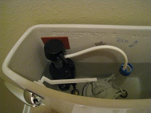

    I'm new to posting in this forum, but I've been a frequent lurker since we bought our house a few years ago and I knew the inevitable change to 1.6GPF toilets was coming. As a "Jack of Many Trades" for 6 local nursing homes, I replace anywhere from 10-50 toilets a year when I'm not working on HVAC or electrical problems. We've always been pleased with the Toto brand that our local plumbing supplier carries, and after reading what many of the professional plumbers here have to say about the Toto Drake models, I was pretty well convinced that the Drake would be my choice when it came time to change out the toilets in our house. I was close to making my purchase last week, but I decided to check out the latest offerings at Lowe's, and that's where I stumbled onto the Cadet 3 from American Standard. This really threw a wrench in the works since I knew all about the problems people reported with the dreaded flush tower in the American Standard Champion, and I was already convinced that the Eljer Titan (Consumer Reports rated #1 in August of 2005) was not as good of a value as the Toto Drake, at least based upon the many reviews and opinions here and on another plumbing forum. But what about this fairly new Cadet 3 model from American Standard?
    I needed to find answers, since the specs on the Cadet 3 looked at least as good as the Toto Drake, Well, on Thursday night, I poured myself a half-gallon sized jug of Diet Pepsi and got busy searching for these answers. It seems that most of the professional plumbers that post on these forums are not willing to "take a chance" on American Standard after the problems with the Champion's flush tower, so they will continue to speak highly of the Toto Drake and not think twice about charging their customers a higher price to avoid potential callbacks. I know this may sound harsh, but if they actually took a good look at the Cadet 3, they would see that there is a lot of great features in this inexpensive, very high performance toilet. Here's what I was able to learn by keeping an open mind and pulling one of these toilets out of the box at Lowe's:
    • Very high quality look and feel.
    • Fully glazed 2-1/8" trapway.
    • Fluidmaster 400A Fill valve and brass tank bolts.
    • EverClean silver based anti-microbial glaze that resists bacterial growth.
    • Very nice 3" chemical resistant plastic flapper.
    • 5 year Warranty (that even covers the flapper)
    • Scored higher than the Toto Drake and the Round Front Eljer Titan in flushing performance in the latest MaP Testing (Click here to read the latest November 2006 report.)
    As you can probably tell from my enthusiasm at this point, I learned enough from my research into this new model, and now I am the proud owner of the American Standard Cadet 3, and wouldn't hesitate to recommend this toilet above any of the competition's best toilets. I fully expect this toilet to de-throne the Eljer from the top spot the next time Consumer Reports does an updated batch of testing. The very high quality feeling is a nice surprise considering the very low price. The flushing performance is as good as any other toilet I've ever seen. About 3 seconds and EVERYTHING is gone!!! The bowl washing seems more than adequate, possibly due to the EverClean coating, but either way, the bowl gets clean with each flush. Refilling takes place very quickly and very quietly. And while I'm raving, let me not forget to mention that this is all coming from one of the lowest priced toilets on the shelf at Lowe's. I know that for a professional plumber, there is no real reason to look for a lower cost alternative as long as your customers don't mind paying the price for a good high quality toilet, but most of the people looking for answers on the internet are also interested in finding the best value for their money. Thanks for listening,
    Bob
    Cadet 3 tank

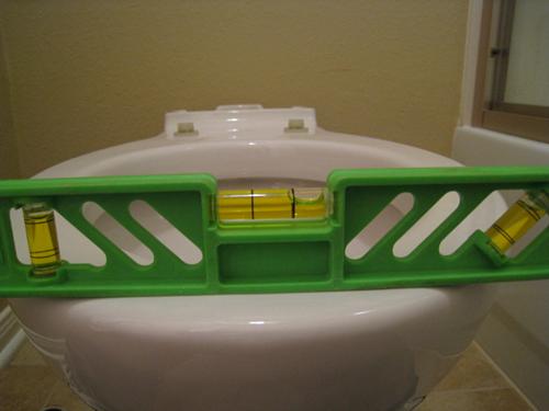

    Default My experience with the Cadet 3
    Cadet 3 bowl
    I installed a AS Cadet 3" about 6 months ago.
    In summary - I had to go back to HD a few times to get a bowl that wasn't defective (wasn't flat on the bottom or wasn't fully glazed).
    I have had the toilet installed for about 6 months and have put it through some severe "stress" tests and admit that it has never clogged. Relative to the previous toilet that was installed - I'm impressed. Very strong and efficient flush. Not extra ordinarily noisey.
    I am still a little concerned about overall quality of the unit based on the initial quality problems I had finding one that wasn't defective. I'm wondering if the unit is going to start developing leaks or parts failing. Only more time will tell.
    I'm impressed enough with the toilet that I'm going to replace the other two in my house with the same AS Cadet 3. I fully expect to have to go to HD or Lowes and open every box and inspect the bowl before purshasing to avoid 3 separate trips.
    I was initially going to use Toto Drake until the only local dealer quoted me a very high price and long delivery time. At the time the new report came out on toilets that showed the Cadet 3 performing very well relative to the Toto's (you can find it on the internet if you do some searching).
    I really don't care where the toilet is made as long as its the best unit for the $$$.
