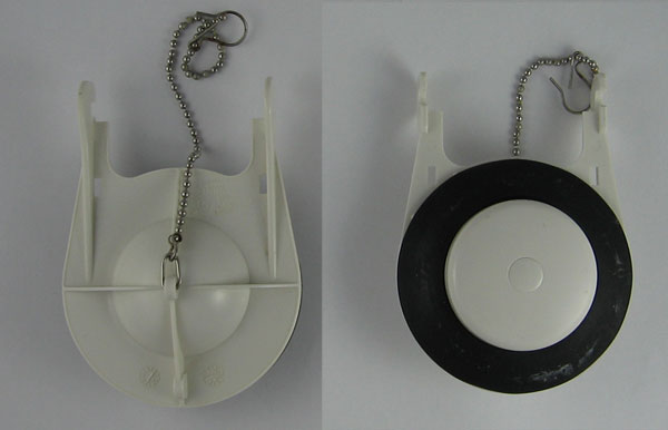

    Default Korky Cadet 3 flapper
    I experienced the problem with blisters on the flapper casket last year and AS sent new flappers (I have two Cadet 3's). The replacements developed the same problem after several months. I have been bursting the blisters as an interim repair. I was happy to learn that Korky finally has a replacement flapper and went today to Home Depot to buy one. I noticed that the only three on display had been opened & repackeged. I asked the clerk if he knew why the flappers were returned. He stated that people open packages all the time and that if I had a problem I could just return it. Now I know why -- they don't work. You can't just push the lever to flush -- you must hold it down. The flapper closes imediately after you release the lever. The package clearly states that it is a replacement for Cadet 3 and includes the toilet model number that I have.
    Blisters develop on the black rubber seal.

    Many 3" flappers close quickly. The original Cadet 3 flapper closes quickly too. Since you are only using 1.5 gallons or so, they must be quick, or the whole tank will drain.

    Thanks Terry. I should have been more specific -- the toilet will not clear waste unless you hold the lever down. I have adjusted the chain with the minimum of slack.

    I have said this time and time again. Adjust the chain. It sounds like you need to slacken it off a little. Cadet 3s are very sensitive to chain adjustment. Get it right and it will be trouble free for years.
    My Korky flapper also came with the box opened. But it works just great. There are numerous design improvements over the OEM version. The rubber, the chain, the way the chain attaches to both the flapper and the flush mechanism, and the way the flapper attaches to the overflow tube. All better than the original.
