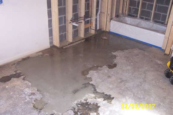

Moving right along on my basement bath project, the last thing I thought I'd screw up was the concrete patch. - I'm not real sure what to do at this point, but I poured 14 bags of 80lb quickrete and one week later, the finished floor surface is rough and gritty. Anytime I walk on it I kick tiny particles of sand. If I sweep it w/ a push broom, cement dust kicks up into the air. I'm thinking I used too much water and/or finish-troughed it too much.
My intent is to tile the bathroom and I don’t want to have bonding issues w/ the mortar down the road. Does anyone know of any products I might be able to put on it to fix the issue? Is the only fix for this to jackhammer it back out and re-pour?

There are different grades of SackCrete or QuickCrete.
The least expensive should not be used for any project that requires finishing. It has too much large stone, and too little sand and cement.
Problems with concrete often arise from too much water and too little water.
When it is mixed, the mix should be only as wet as necessary to place and finish it. It should stand in a pile. It should not run. When you are finishing it, you should float up enough fines (sand and cement) to get a smooth surface. If you get a puddle of water when you finish it, you used too much water.
After it sets up and is not susceptible to being washed away, it shold be kept moist. The cement needs water to bind the molecules into what is called a hydrate. Too little moisture, as from low humidity in the winter, prevents curing of the surface.
Concrete should never be allowed to freeze until it is fully cured; at least a couple of weeks.
At this point, you probably need to scrub off the loose stuff and go with a tile set mix that may be used thick enough to give you the spacing that you need. http://www.tileusa.com/thinset-mortar_faq.htm#medmortar
You are not likely to be able to "fix" the problem as good as you can do with a medium bed thinset.
JeffV
26
This is EXACTLY what happened in my situation...
"...When you are finishing it, you should float up enough fines (sand and cement) to get a smooth surface. If you get a puddle of water when you finish it, you used too much water."
At least I know what I did wrong. My only past experience w/ pouring concrete has been filling a hole in the ground for a deck footer - not a situation where the consistency seems to matter as much.
Thanks for the thoughts and link for the medium bed mortar - that's exactly the approach I'm going to take in fixing this.

JeffV
26
I had taken pictures after I poured it and floated it. Incriminating evidence below. I think I could have gone for a swim! Yikes :eek:
