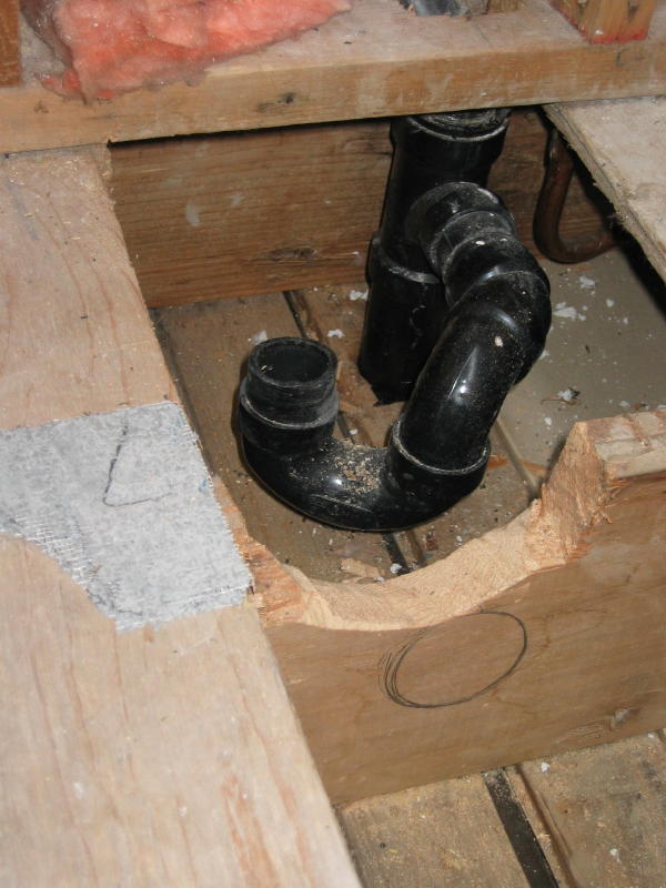

Hello,
I am new to this forum.
My husband and I are currently renovating our ensuite. We have removed the bathtub and are planning a large walk-in shower unit in it's place. We have purchased the 32 x 60 Schluter Shower System with an offset drain, hoping to utilize the current bathtub drain location (upgrading to a 2" pipe of course).
Upon examining the existing plumbing, we can see that the bathtub drain was placed directly over a joist (notched to accommodate the drain fittings) - and upon examination of the Schluter drain system, we realize that we need to go almost 4 inches deeper with the new drain fittings.
The 10" joist (on 16 inch centres) is currently notched about 3" and we will need to cut another 4 inches to build a 2" drain/trap to accept the Schluter drain. That would leave less than 3 inches of joist. The shower is on the outside wall, we estimate about 24 inches to the outside wall would be compromised.
The offset drain in the Schluter foam tray is 10" from the edge, and to keep the slant from the edge to the outside of the drain, we have very little to play with.
I am anxious to hear any and all ideas from the experts.

I think you'll need to cut that joist out and put in some headers on either side of it so you've got a reinforced box around the drain..
Racer814
124
North Carolina
street 45 in the drain to angle out of the joist and then another to offset it back
or cut and header the joists

A street fitting is male at one end and female at the other, and the suggestion here is that you first angle away from your joist rather than cutting it more. So, something like a couple of street 45s would let you dog-leg over a bit before going farther on down below the existing notch in your floor joist.

Picture for clarity
Hi again, I am attaching a picture of the situation today. The circle that I drew on the board was from the shortest 90 degree elbow that I could find attached to the drain. This circle marks where the curve of that elbow would sit if the joist weren't there. As you can see, there is not much room from there to the main pipe and I need to get a trap in there and also a conversion from 2" to 1.5". I understand that I need to maintain a slope also.
does this give you any other ideas? Should I just get a plumber in to look at this and make it right? I think I am over my head a little.

I would not use 2 45's that just makes the potential for a clog. The best thing to do is as Jim suggested. Cut the offending joist out and box around the area. This will return the support lost when cutting out the joint and provide the space needed.
1st - you cannot place a 2" trap here and reduce it to 1-1/2" to fit into the existing tee....
You have to replace the SanTee with a 2" tee and plumb it from there...
Once this is done, you can figure out the best way to run your drain - in the long run the boxing out of the joists will be the best option...
If you are not sure of what you are doing, take lots of pictures and make lots of drawings and, for the most part, we can talk you through the piping part - for the tiling, go to John Bridge's forum http://www.johnbridge.com/vbulletin/index.php? .

thanks. Just to confirm, the San Tee is the pipe furthest away in the picture? I hear you say that I need to cut that one out and replace it with a 2" T, but there is no room to accomodate an even bigger pipe and 2 to 1:5 connectors or is there? I haven't seen them at HD but I will go back and look again if you tell me that I should be able to squeeze this in.

Hello, what is it you are not understanding? Remove a section of the joist that is in way and box around the work area. Also, you can not reduce the size of the drain from 2" to 1-1/2". That would be an open invitation for clogs. You really don't have a serious problem here if you will just remove the joist.

I will probably get shot for this, but it looks to me like that circle you have drawn is near the center of the joist, and if that project was my own, I would plate both sides or "make a sandwich out of" that joist to return it to its original strength (or at least very close), then drill the hole you need where you need it. And rather than trying to retrofit to 2", I would keep that bit of pipe (aws a nipple) already coming out of your tee and use it for connecting your new trap. But of course, neither was McGyver a plumber ...

Thanks for the suggestion. The Schluter shower drain is 2" and the old (existing) tub pipes are 1.5", so I must make the conversion somewhere in there. Mark has suggested that I swap out the current 1.5" SanTee and replace with a 2" SanTee - but this will require that I change the pipe connections coming in and going out of the SanTee. I can't possibly replace all the plumbing to 2", somewhere I have to end the 1.5" and I am up against another joist at that point.
Do you think that I need to start at the SanTee with the 2" ?

you may not have enough room for 2 45's anyway...2 streets maybe, thats the easiest way if you have room....headering the joist on the 2nd floor aint no picnic , I would avoid it if possible...........the shower drain should be 2" by code....how hard would it be to change it? .....would it work going into a 1 1/2" drain...yes....is it a really good idea?.....no
you would do yourself a favor by getting a proffesional in there...

The picture may be confusing everyone - the circle that I drew on the board shows where the drain and a short elbow WILL REST on the joist, it was a 'depth' indicator. So you see, the problem with sistering and drilling a hole won't work because I actually need that much depth in the board for this Schluter drain system and an elbow to get off the joist. I will attach a picture of the Schluter drain as fyi.
Otherwise it would have been a great suggestion. I could still bolt a 2x4 (on end) across the length of the joist if I cut down to the 7" mark on this 2"x10" joist, then box it in from there - do you think that would be strong enough?
