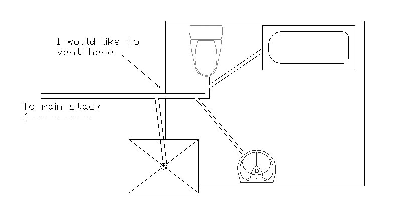

Ok, here is a sketch of my bathroom. Hopefully this will help make sense of what I am trying to do. Any suggestions?
Geniescience
Homeowner
2,137
i take back what i said above
wolf
based on what you drew, you are missing a lot more than a vent. Of the four walls, which ones can you send a vent down inside? Tell us that first please. The principle is to orient, or direct, your drains to the vent and then combine the now-vented waste pipes.
david
p.s. also draw the thickness of the walls please. I don't understand how the shower fits in the wall.
wolfpack
Of the four walls, I can vent: toilet wall, shower wall, lav wall. This is over a basemet that will be finished, so I am trying to run the main 3" line as close to the center of the room as possible to avoid conflicts with future finished sapce.

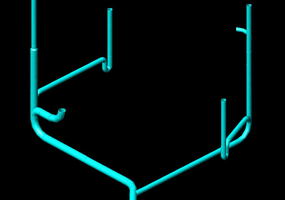

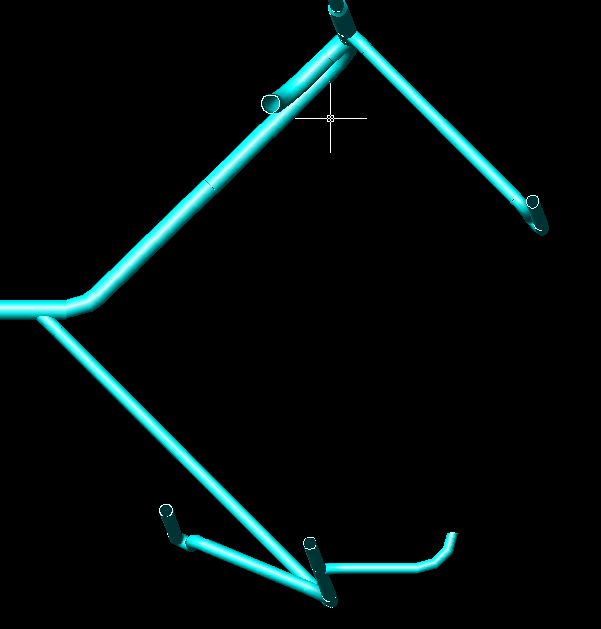

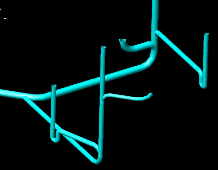

Here is one take on the plumbing...
WC and tub vented together and shower and lav vented together...
