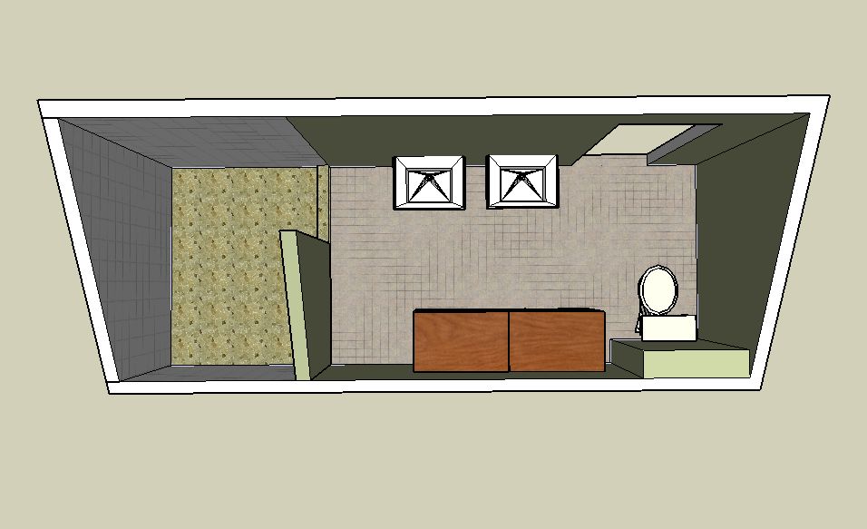

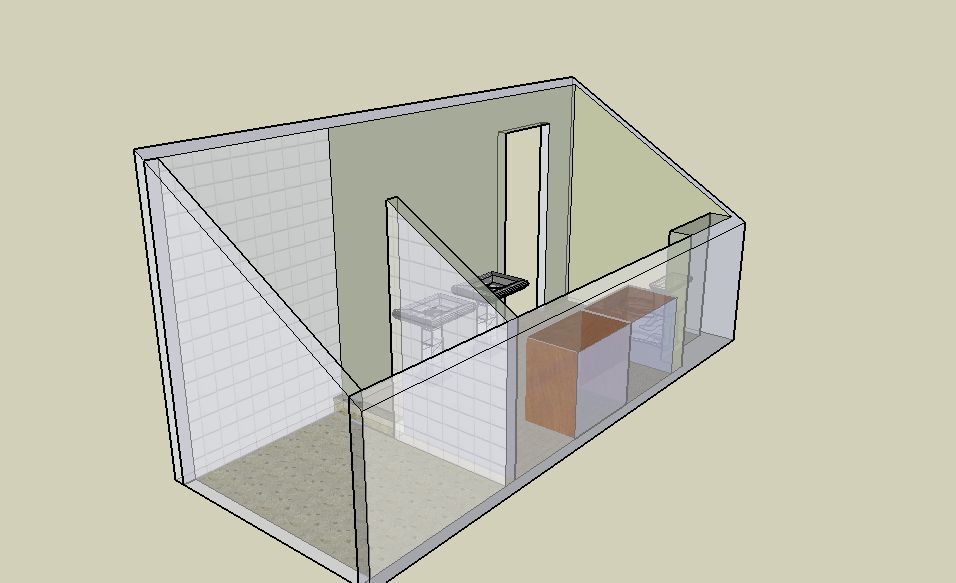

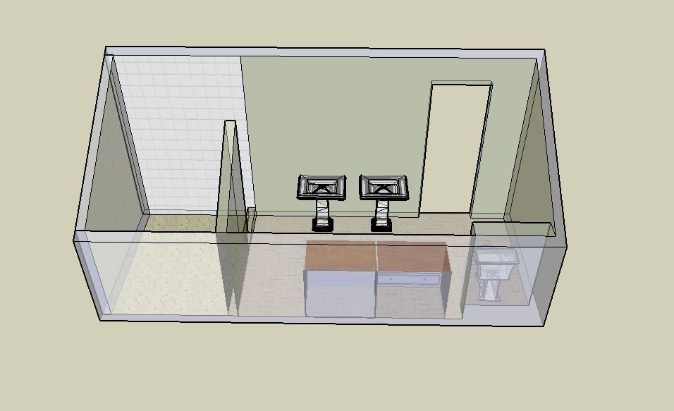

    Default Here's what I have so far...
    I might think about only doing one sink and moving it to the wall by the toilet and then moving the toilet over to the center of the room... Depending on what the permit office has to say. I think I'm going to have an issue with the door though. If I swing it into the bathroom, I think it's going to hit the ceiling assuming an 80" height on the door. Any solutions here other than have the door swing out instead? Here's a couple photos of the plan so far. I welcome any other ideas.

    Default tuck toilet away, so you see another focus when you enter
    assuming all drains can go anywhere...
    i would tuck the toilet away, near the shower, so that upon entering you see something else primarily.
    i would extend the thickened wall right across the whole bathroom and make it storage or open shelving or a combination of both. Even in the shower. With a bench in the shower on that side too.
    i would put the sinks on the big thickened-wall storage side, so your tall wall is the edge of the passage to the shower. The sinks would then be roughly in the geometric center of the space as shown today, but would appear to be on the back wall.

    Default What about mirrors
    What would you do about mirrors if you put the sinks on the short wall?
    Nov 2005
    2,152
    Default hang two oval mirrors, one behind each sink
    i would hand 2 oval or round mirrors.
    In front of really nicely built open shelving made with large porcelain tiles. that is what i would prefer. But i'm only fantasizing about some ideal place and i haven't seen your reality.
    david
    DIY Senior Member nelsonba's Avatar
    Sep 2005
    Minnesota
    Default Don't think that will work
    The wall isn't tall enough to fit a mirror. I've got an 8-12 pitch on the roof line. Wouldn't want to mount it to that. I think the sink would have to go either at the end or on the tall wall. I'm going to call the permit office and see what the code requirements are for ceiling heights.
    Thanks
    Nov 2005
    2,152
    Default i agree. use the ceiling.
    sorry i didn't spell it out. forget that back wall. it is too short. we agree.
    if you want my idea, it goes like this: hang mirrors from the ceiling.
    Build shelving along that short back wall, instead of building a whole new wall, which loses space and makes your bathroom into a long narrow room.
    i always use the ceiling
    david
    Nov 2006
    2,316
    Quote Originally Posted by nelsonba
    Try a round-top or corner-cropped door!
