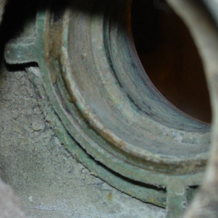

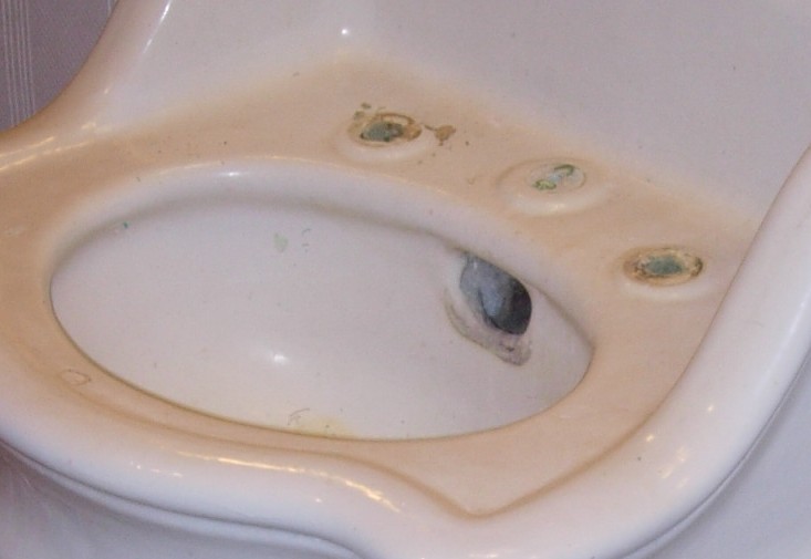

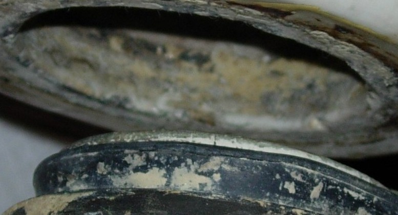

    I have an antique ceramic sink vintage 1901. My intention is to have it reglazed, however I have been unable to remove the strainer - and so has my plumber. The problem is that the strainer is not exposed from the bottom of the sink - there is a 3 inch gap between where the spud connected to the bottom of the sink and the bottom of ths strainer. And the hole is too small to get a tool in. (On the bottom of the strainer there are 4 prongs that could be used to turn it.) We've discussed cutting it off, but we're afraid to cut the sink and we're also concerned that the strainer will not fit back through the overflow area. I'm having trouble attaching pictures, but will gladly send them if anyone wants to take a look. If anyone has any brilliant ideas, I'd greatly appreciate them. david_talton@hotmail.com

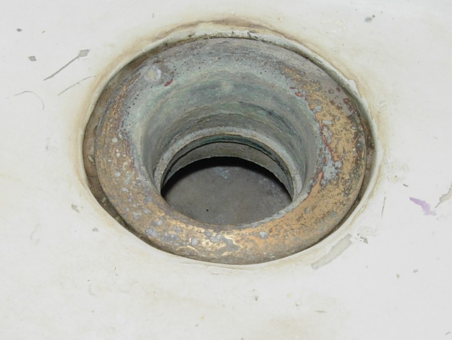

    Default Here are the pictures
    I think what is unique abouot this sink is that there is a space between the bottom of the strainer and the spud connection. This is about 3 inches of open space that is in the middle of the overflow drain. I think there are two options - one is to find a tool that will screw off the bottom of the strainer. If this is done the bottom of the strainer can be extracted through the overflow. If it is cut out I am concerned that the piece left to pull out will be too thick to be pulled out of the overflow. (It would be a cylindrical piece about 1.5 inches high.) I hope these photos help!

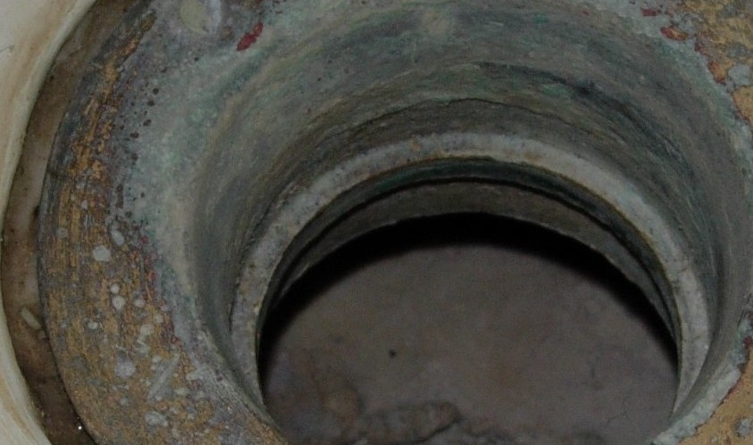

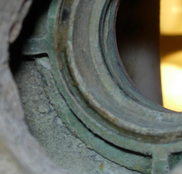

    Default A couple more pictures...
    These are looking up through the hole where the spud connects.
    There is a couple inch open gap above the spud connection below the strainer. So any tool would need to get up through the spud connection hole to reach the strainer. This hole is only about 1.5 in in diameter, or slightly larger, so it I'm not certain what tool could fit. None that my plumber had.

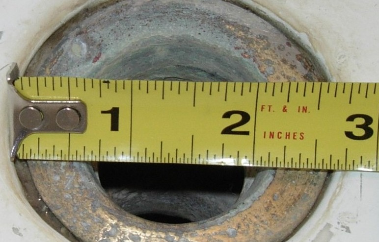

    Default thoughts on your suggestion...
    Mark,
    That is a good suggestion. The only problem is that the opening at the bottom of the sink where the spud connects is only slightly larger than 1.5 in.
    and the inside diameter of the sink strainer is 1.5 in, so the nut on the bottom with the 4 prongs is closer to 1.75 in. (This is hard to see in the picture I sent.) This presents two problems - the tool that you suggest isn't wide enough to reach the prongs on the strainer - and once I get the nut off the strainer the only way to remove it is through the overflow (which I think is doable). So I almost need to come up with some tool that is flexible to get in through the bottom, or something that can be assembled inside the overflow.
    The other options is to cut it out - e.g. with a Dremel. My plumber says he will go through 50 blades cutting this out and that there is a possibility he will damage the sink - so I told him to hold off.
    Any more ideas?

    DIY Senior Member Phil H2's Avatar
    Sep 2006
    Tujunga, CA
    125
    Did your plumber try using a large basin wrench?
    http://www.ridgid.com/catalog/RT2004-011.pdf
    Default basin wrench...
    THe basin wrench my plumber tried would not fit through the 1.5 in opening where the spud connects. I looked similar to the one in the picture.

    In the Trades Bob NH's Avatar
    Oct 2005
    New Hampshire
    3,308
    I would make up a steel bar with notches for two of the ears. The bar would have a hex bolt head or nut or a 1/2" drive socket welded onto it. The bar would fit endways into the hole, and then tip to engage two of the ears.
    Then I would put a 1/2" drive impact wrench on the hex bolt head or nut.
    You can't stack up a lot of pieces with an impact wrench without losing effect. Keep it as short as possible with as few pieces as possible.
    If you are lucky, you will be able turn it with a power bar. If not, you can use the impact wrench. Impact usually loosens up things that would break if you tried to turn them with torque alone.
    A good soaking with Liquid Wrench while you are making the tool would be a good idea. Maybe some heat if you can get it in there.
    There is probably value in saving the metal parts because they will be hard to replace.

    Default more on this...
    Thanks for your additional ideas on this. I have been away for the holidays so haven't done much additional work or thinking on this.
    Bob NH - The idea of making a steel bar to try to turn it sounds like a good possibility. I would need to find someone to do it. Then there's the whole question of if I do get it loose whether I will need to replace it or what.
    Regarding the spud - the spud connection at the bottom of the sink is entirely separated from the strainer. It is about 3 inches below it. (the space between the strainer and the spud is open and is where the overflow drains. So the only real function of the strainer is to hold a disk to keep hair and stuff from going down the sink.) I don't know much about spuds, but from what I know it is a standard spud and will just need to be reconnected when I finish renovating the sink.
    To the best of my knowledge the sink is the same vintage as the house: 1901.
    Lastly - there was an idea of cutting the strainer out with a Dremel. My plumber said it would take him '50 bits' - but I wonder if it were a diamond bit if it might go faster. Of course if it gets cut out then i definitely need to get a new strainer. But I don't see this as a big problem since the strainer wouldn't need to actually connect to the spud, just something to keep large things from getting down the drain.
