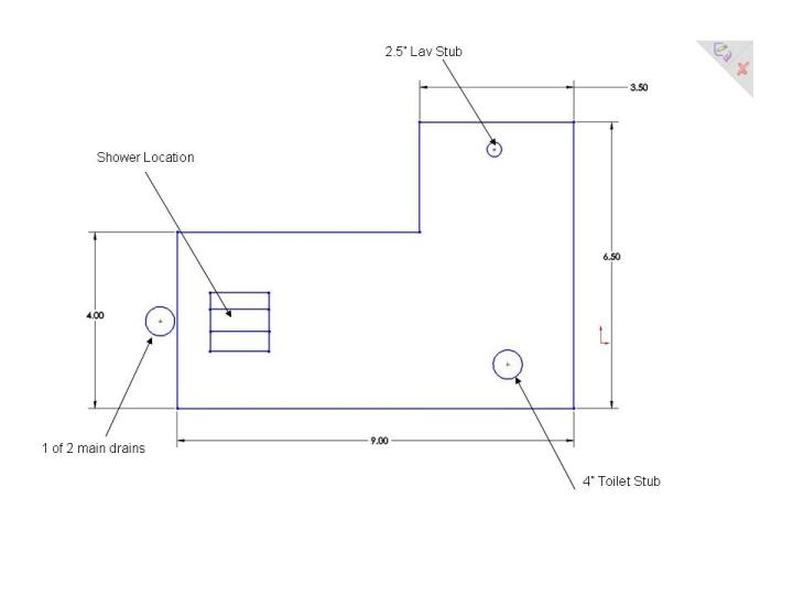

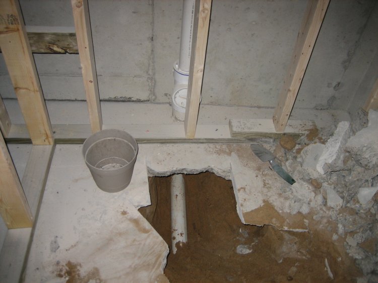

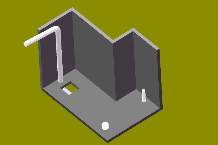

    I am finishing my basement that was roughed in for a half bath. I want to put a shower in and make it a full bath. I have broken up the cement in the area where I plan on putting the shower. The main line is right underneath where I broke out the cement and plan to put the drain. My question is can I Tee right into this main line? Do I need to vent the shower if I do this? I know I have to put a trap in but what kind would this be for this installation? I have attached some pictures to show the layout and to clarify my questions.

    hi rbly. I may be able to shed some light. First, i'll comment by adding what you probably already know.
    1. your jpg's haven't shown any venting at all; this full bath needs vents somewhere.
    2. "main line is right underneath" I saw the pipe right under your shower space, in the center. That is not good if you intend your shower to have a center drain right above the pipe, because you need room for the p-trap, the little stub coming out sideways, and the fitting on the main drain!!
    3. All traps are always P traps, AFAIK. The bottom of the p trap is down below the height of the main drain, otherwise is acts as an S trap, which is not good. Do not use drum traps either.
    4. i think the right way to connect your shower to the main drain line is with a Wye and not a Tee, and if that is the case then the right way to refer to it, is to avoid using the term "Tee into".
    Depending on how you arrange your vents, the shower may be vented sufficiently, so it is not possible to comment on whether or not your shower needs venting "per se" all by itself. Although some could say that you need three vents for three drains...
    General rule: Plan vents first. Then shoot drain (after its trap) over to the vent, so it is now vented, and then turn drain to the main drain and connect with a Wye. Everything depends on where you vent upstream of the shower p trap. AFAIK.
    david

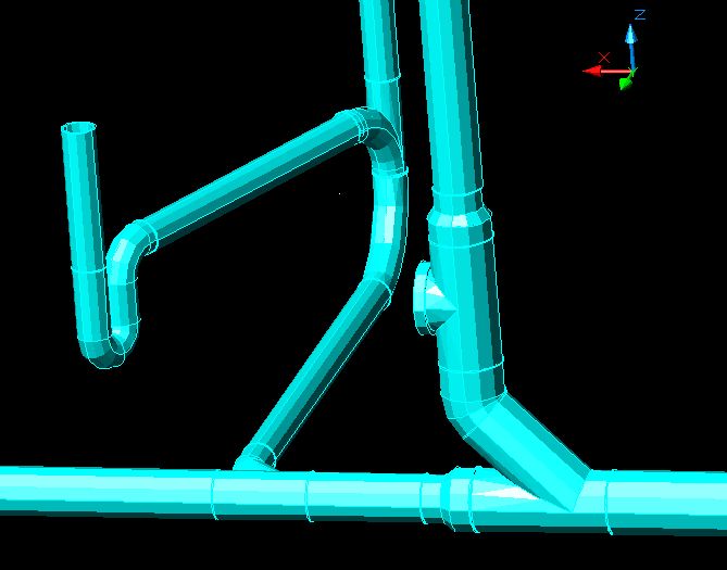

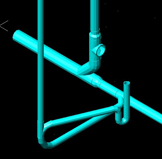

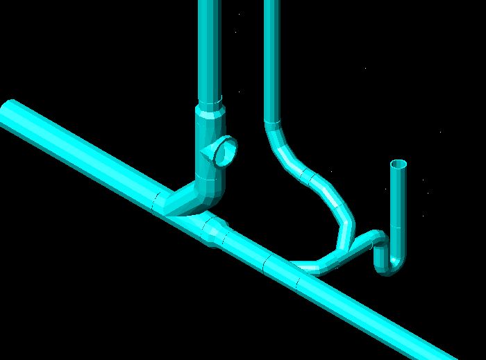

    Here is my first try - problem is you do not have a lot of depth to play with and I don't think the 3' can be the vent - looks like an upstairs waste line...

    You'll have to tee into that main line from the side, so your shower will have to be to the right or the left of that line. If it were me, I'd build the shower to the right, then I'd run the trap straight back (parallel to the main drain) until I got just beyond the wall frame. Then I'd run a vent up behind the wall, and just beyond that, I'd sweep 90 into the main drain line.
    Alternatively, run the trap at 45 deg to the main line such that you can wye into it just beyond the wall. Just b4 the wye, you can run the vent arm up.

    Commercial Plumber markts30's Avatar
    Sep 2006
    Phoenix, AZ
    630
    It would be helpful if we knew how much depth you had to work with....
    What is the dimension from the top of the 3" pipe to the bottom of the slab?
    I considered drawing the plan to show a combo on it's side then sweeping up into a san tee (street if required) under the wall and swinging the tee to the P-Trap (venting out the top) but did not think he had the depth ....
    As well, I looks like there is an existing 4" combo under the wall with a bushing in it leading to the 3" line under the slab...
    Note: looks like you are going to bury the 4" cleanout - I would try to avoid that if I were you... Inspector might not like it....LOL.
    There is 12 inches from the top of the main to the bottom of the slab.
