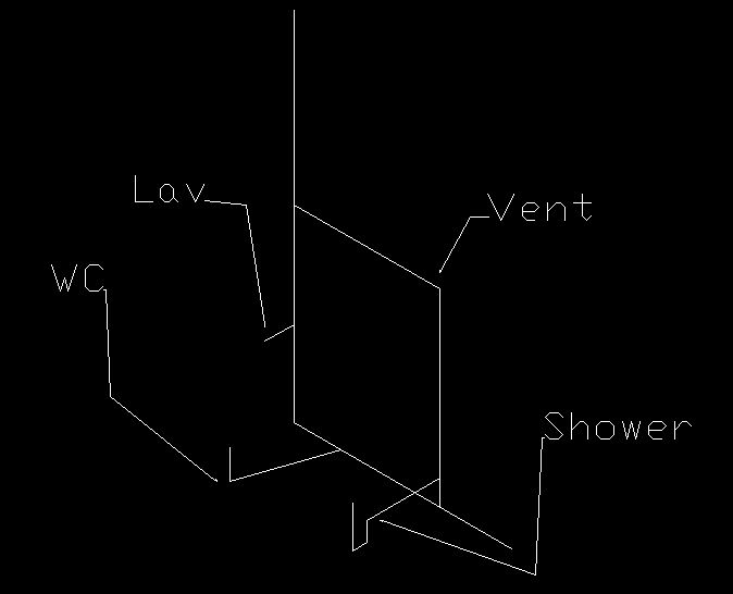

I am putting in a shower in our second story bathroom and am wondering if this is a sufficient method of draining and venting.
Shower drain to 2" p-trap, then out to 3" horizontal waste line (distance from p-trap to waste line is 4-5 inches). The connector at the 3" waste line is a sani T connector (does it need to be a wye connector?). The flow of waste will be to the right down the 3" horizontal waste line. There is a 2" vent stack about 12 inches to the left of where the shower meets the waste line that is also used to vent the toilet. Do I require an additional vent or will that one work?

You can't wet-vent a fixture (shower) downstream from a WC. The 3" vent changes from vent to drain where the sink connects.
The sink and the WC are "deemed" vented, and the WC is wet vented thru the 3" stack. Not sure what the 2" vent line does... unless it continues down to the lower level(s). If not, you could probaly connect your shower drain into that. Else, use it to vent your shower.
You can only use a san-tee to change from horizontal to vertical in a drain. (someone pls correct me if I'm wrong)
Not impressed by the 1/4 turn of the 3" stack (where it changes form vert to hor). Is it a LS (long)?

I'm getting somewhat of an education on this forum. In the past I would have only vented the end of the drain and tied into the shower drain. From what I've learned here it seems that each branch off of the main drain is vented if it is to be by the book. Some codes do not permit a sani-tee to be used on its back... I'm not sure why except maybe for clean out purposes..

Boy am I confused...I actual thought I had this one close to right.
Maybe I should walk this one through 1 question at a time.
1. Is it okay to drain and vent the sink the way I have it? (The 90 at the bottom of the 3" vent is a long elbow)
2. I have read in many places that the toilet had to be vented downstream. I therefore thought I could not use the 3" stack as the vent and that is why I put in the 2" vent further along (it does not go down to any other levels).
3. As I am very tight for space for the shower (the drain in the acrylic shower pan is 12" x 12" away from the corner) I was hoping I could get away with using the 2" vent that would be the distance of 1 wye towards the toilet. What other options would I have here?
Please tell me what's right, what's wrong and how to fix it. :confused: :confused:

Blaze:
0. I'm not a plumber
1. Yes, as long as other code criteria are complied with.
2. The 2" vent, as drawn, is venting the horizontal portion of your waste/soil stack, not the proposed shower.
Sink is OK, Toilet is OK. If you can tie into the stack upstream from the WC, you'd probably be OK without a vent. Other option would be to extend the WC connection and tie it into the stack downstream of your proposed shwr hookup. You're allowed up to 4 fixtures "above" the WC without a vent, subject to a handful of conditions (e.g., verticle soil stack 3"+; no waste from above; max 2 WC's; top fixture connection into vertical portion of stack; all on same floor; drain connections direct and independent; max drain dia. above WC is 2", total fixtures above WC =< 8)
Or, you could run a separate shower branch (as you propose) and vent the brach into the stack (above the highest fixture flood rim). The vent vould have to be min 2x drain dia from the weir of your P-trap.
All in all, I don't see how you could cram any of that into the space you have available. You might consider connecting a (vented) shower branch somewhere else into the stack.

It appears to me that the vent between the toilet and shower is useless and needs to be tied into the shower branch which would also vent the toilet and prevent the toilet water from siphoning out the trap of the shower. Sink looks fine to me.

So, if I was to put a 2x2x1.5 wye between the shower trap and the 3x3x2 wye on the main drain and run the vent up and tie it in with the 3" vent stack I would be okay?
This would get rid of the 2" vent between the toilet and the shower.

how much depth do you have over the main 3" waste line?
is the waste line (and extra 2" vent) in a wall?
If there was room, I would take a 3X3X2 wye on it's back vertically off the main and put a 2" santee on top of it. Take the shower drain arm out of the san tee and vent from the top of the san tee...

layout
If you have the depth, I would put a 3" street tee, turned to face the toilet's location, into a long sweep elbow. Then 3" cleanout tee above that with a 3x2 bushing into it. Finally a 2 x 1 1/2 street tee into the bushing. The shower would be a 3 x 2 combo on its back with a 2 x 1 1/2 x 2 street tee facing the shower drain location with the trap at the end of the arm out of the 2" side opening.
