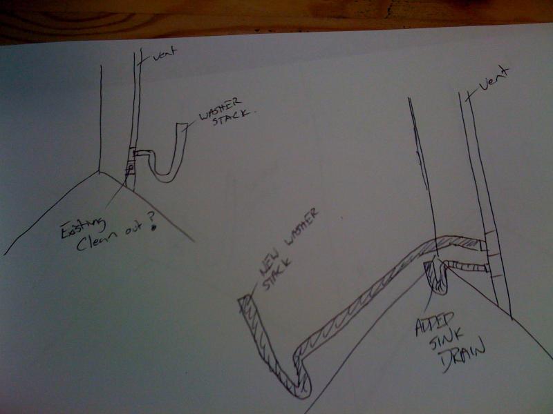

IMG_0001.jpgView attachment 18044View attachment 18043I am planning to move my existing washing machine stack to a different wall, and adding a drain for a utility sink. on my existing layout is the T with a seperate threaded cap my clean out?
I plan to cut both T's out of my vent pipe, and add 2 new ones. The one for the washing machine will need a 45* bend in it to run down the other wall 6 feet. and a second one for a utility sink.
Any addition info you can give me on pitch of my drains,required heights, lengths or clean outs would be great!
Existing picture on the left , new layout on the right.
Thanks in advance!!!

Swapping would be better, and then adding a vent for the washer trap arm, and then reventing the two vents at 42" makes it legal anywhere.

Your help is greatly appreciated Terry. If I follow you correctly, you are saying to add a "T" before the Washer trap, and run a vent up, and back over to my existing vent and tapping into it with another T connection? I am unclear as to where this 42" measurement applies to.

Judging from that picture, i am assuming the 42" is the minimum above the washer trap arm that the vent must connect? And that a trap will be connected after drywall for the sink?
3,458
In plumbing, 42" is a good number to tie the vents together. It puts you 6" above a 36" kitchen cabinet and sink.
They want six inches above the "flood level" of the fixtures for connecting the vents.
The picture above was a rough-in before drywall. The p-trap gets installed at "Trim".

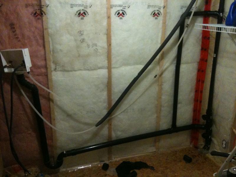

well ive got it pieced together without glue an strapping for now
- 1/4" drop per foot on washer arm
-trap 5' from its vent
-vent connection well above 42" from floor
-washer "T" connection below future sink "T"
-clean out on bottom
-I will strap every stud
What do you think
3,458
The santee on the far right on the re-vent should be flipped the other way.
The picture is a bit fuzzy, I'm not sure the other tees are the right way either.
What do you think
ABS piping CANNOT be dry fit together, it doesn't fit the same with vs. without solvent cement.
The sanitary tee where your vent ties in above should be flipped.
The rest is a little too hard to make out.

Here is a better picture of the re-vent on the washer arm. my thinking was that the air would be on top and easily flow upwards this way? Can you clairify with this better picture?
The other "t's" on the stack are regular T's with no sloping part. Im assuming the sloped part in the middle of the T makes it a sanitee?
* I would never leave pvc unglued, or unstrapped, hence the "for now"

Really sorry for the crappy pictures. everthing is 2" except the actual vertical vent piping. how do the "t's" and sanitees look
3,458
On the trap arm, the wye is pointed so that if any water is poured down the vent, it's directed down the line.
And then we reverse that on the vents above.
