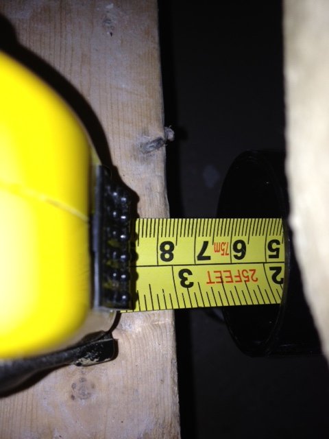

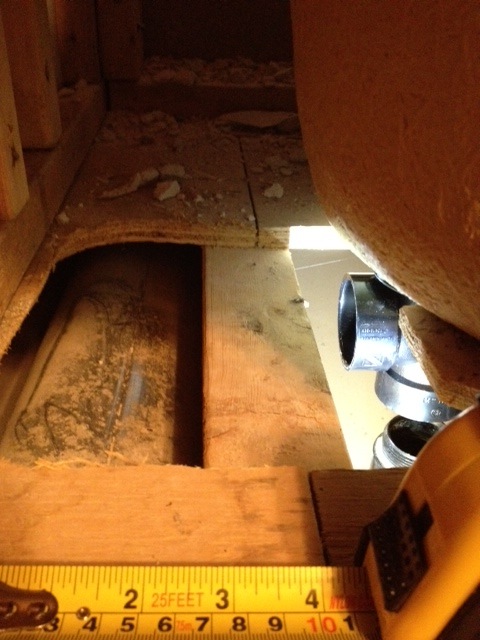

I have test fitted an OS&B ABS direct drain tee and it fits perfectly, but my problem is I cannot fit the ABS elbow and short pipe for the overflow to the tee due to this very tight clearance to the flange of an I-Joist directly in front of the waste pipe. I basically have 3" of clearance from the centre of the drain to the edge of the I-Joist flange. I have read that even slightly notching an I-Joist is a big no-no so that is out of the question here. Here is a pic (sorry for the quality) showing a measurement from the centre of the tub drain to the edge of the I-Joist flange (OS&B ABS direct drain tee is loosely screwed in here and measurement is from the centre of the drain):
Attachment 16749
Attachment 16755

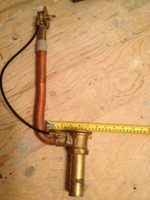

Are there any other options here that I am missing? The old waste/overflow extends further than 3" but uses a much smaller (looks like 1") flexible corrugated pipe for the overflow and so manages to barely clear the top of the joist flange. Here's a pic of the old one FWIW:
Attachment 16750
