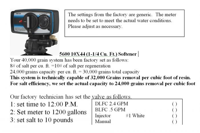

This is the way I would set it up since he has a 5600. I have inserted our programming guide we send out with our 5600 system.
5600 10X44 (1-1/4 Cu. Ft.) Softener
Your 40,000 grain system has been factory set as follows:
8# of salt per cu. ft. =10# of salt per regeneration
24,000 grains capacity per cu. ft. = 30,000 grains total capacity
This system is technically capable of 32,000 Grains removal per cubic foot of resin. For salt efficiency, we set the actual capacity to 24,000 grains removal per cubic foot.
Our factory technician has set the valve as follows.
1: set time to 12:00 P.M.
2: Set meter to 1200 gallons
3: set salt to 10 pounds
Assembler_____________
Attachment 15168
This may need some fine tuning for your application but it should help.
Wow! That was informative and very helpful. Thanks.
