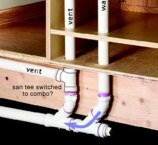

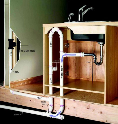

First I'd like to thank everyone who helped me set up my DWV, passed dry fitting inspection first try. Thank you.
However, I had one fitting that the inspector wants me to change when I glue.
My foot vent looks just like the first image except I put a clean out on the vent above the floor.
Attachment 10989
My question is with the second picture:
Attachment 10988
The picture here shows a San Tee being used, however my inspector wants a wye combo there instead. My first reaction at the time, do whatever the inspector says, but now that I'm gluing the combo is adding about 2", dropping the drain below the ceiling in the basement, which I was hoping wouldn't happen. :D
Any suggestions? Should I challenge the inspector or just do it like he wants and deal with a drop ceiling?
