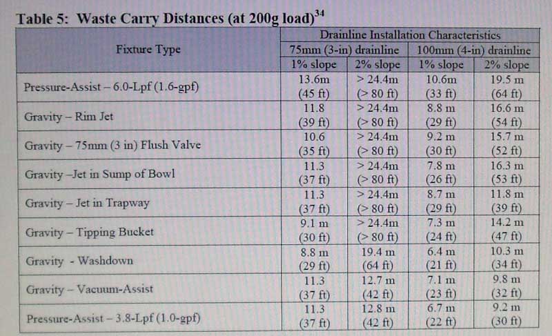

1. Because the house sat so long without running water, could it be old feces hardened causing some blackage?
2. On that same note, we only ran a toilet for 4 months and nothing else. Could this pose a problem not washing the solids down properly?
3. Does solid waste actually sit in the pipes until more water washes them down? The pipe is approx 26ft of run before connecting to the town sewer line.
