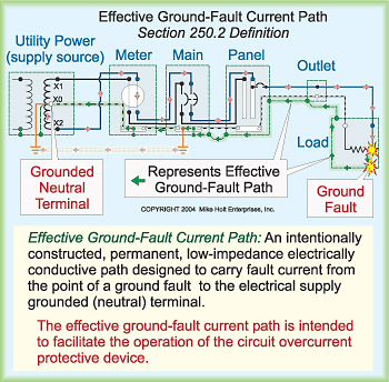

This comment scares the hell out of me, A pump without a low impedance path back to the service will NEVER trip the breaker, the earth is NOT a low impedance path. Your gonna kill someone.
Actually the NEC does require the casing, if metal, to be bonded with the EGC that supplies the pump motor, NEC 250.112(M) And no, you dont have to use the well casing as a GEC.

ummm can you spell out EGC and GEC?
Also, is the NEC mandatory in all US States and local jurisdictions?

EGC is Equipment Grounding Conductor
GEC is Grounding Electrode Conductor
The Nec is mandatory if your state has accepted it and adopted it. with the exception of state amendments.
Here is a picture to help you grasp the idea of a grounding conductor.
Attachment 5197
