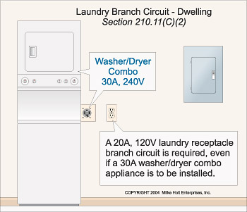

In the process of replacing aluminum wire in house, came across 10-2 Al need to know if 12-2 copper will work to switch it out with. Also have a hugh black wrapped Al wire supplying the washer and dryer outlets, (no 220 plug) it is marked 10-3 with ground what can I switch it out with. Thanks.

After turning the breaker off and testing the plugs in question from the original post, I presided to start taking out the wire. When I pulled the wire up from the metal box it sparked (hugh) and blew the breaker. I had previously checked and made sure the circuit was off, why did this happen? Could the original owners split a 220 circuit and left half unaccounted for? What is the explanation of this. Breaker leading to the plugs was off, no power at either plug but hot wire sparking and blew breaker (which have not been able to reset). There is no 30 amp receptacle anywhere near the laundry area......
