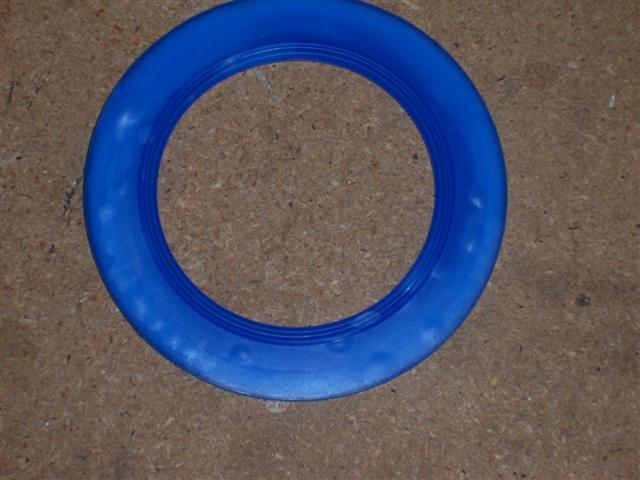

Korky makes a Champion 4 flush valve seal: http://korky.com/Flapper450BP.html Korky is the company that invented the flapper, makes one of the fill valves used on Toto toilets, and makes factory-OEM replacement parts for Toto fill valves and Fits Toto flappers, all manufactured here in the USA. A number of the pros on here recommend their fill valve and flapper for Toto toilets, and at least one highly-respected pro here says that he always uses a Korky flapper when replacing a flapper on a generic toilet.
Check the instructions here:http://korky.com/PDF/450BP.pdf and see if it fits the system in your tank (i.e. compare tank number as shown in the instructions).
Looks like a pretty simple fix (although not as simple as just replacing a flapper...)
If you can't find it at your local hardware store (my local ACE carries it), HD has it in the stores (and only in the store) for $5.98 but uses part number 450CM (rather than 450BP). Same product, but likely packaged differently. (BP likely stands for "Blister Pack") You can use the HD online tool here to check if your local store has it: http://www.homedepot.com/h_d1/N-5yc1...&storeId=10051 (Click the "Pick Up In Store Button" and input your zip code to see the purported local stock level.) Amazon only has it by fulfilling for another company, so it will be a few dollars more through them, but you can look it up there, too.
You can also get the original AS seal online. Part No. 7301111-0070A. If it were I, however, I would get the Korky product because experience tells me their stuff is going to be much-higher-quality than the AS product, which they just get someone to bang out at the cheapest possible price.
Photo of Korky product in blister pack: http://ecx.images-amazon.com/images/...500_AA300_.jpg
PS I notice that one of the HD product reviews recommends that you leave the old seal in and put this one on top. I wouldn't do that. This seal should replace, not supplement, the original seal.

The original blue seal on the Champion flush valve developed blisters and began to leak in less than a year. I replaced it with the red one from Korky (bought it at Lowes) and it has been leak-free for about 2 years.
Attachment 16784
