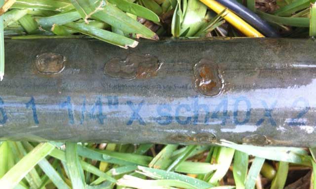

We live on an acre of property that is mostly irrigated. The other day I doing some yard pickup as the sprinklers cycled. At some point I noticed that they had stopped, and not finished.
I check the well, the pump is off (you can hear/feel it hum when its on). I check the timer, it still thinks the pump is on. I check the breaker, its fine. I manually turn it off, and I hear the control relays shut off. I manually turn it back on, I hear the relays... but nothing. I manually turned it off again and open the relax box to see if anything was obviously fried in there and all looked good.

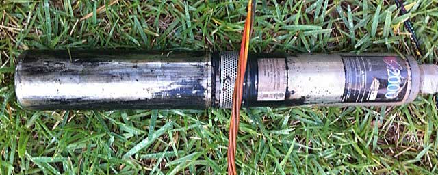

I call the well guy that installed the current pump setup back in 2009. He comes out, and does testing and says its a "DEAD SHORT" in the pump. Its out of warranty (of course) but he says he wants to try and send it in anyways because he buys so many, etc etc....but he says if it got iron all over it, he knows they won't cover it. We do have iron in the water as you can see some stains the sprinklers have left.

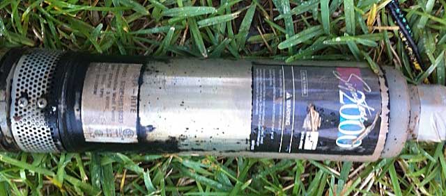

Today he pulled the pump. The first 10 feet of the drop pipe were clean and shiny. The next 12 feet were black like chimney soot black. The next 12 feet were dark metal colored, not sooty black nor shiny, but have weird pock marks on them. I can't explain them, but I'm attaching a picture... I mean its REALLY weird. The last 10 feet were totally duct taped to the wire, so all you see is duct tape.... Then the pump is pretty black as well.
The guy said the well was causing the black soot and the pock marks/pitting. He said the pock/pitting was very unusal, and he'd only seen that in like 50 wells over several thousand that he's worked on over the years. His opinion is that the well will continue to ruin pumps and should ultimately be replaced.
He said they would be back in the morning, so I took the opportunity to take some pictures. Here are some pictures from what was pulled.
Does this guy have any idea what he is talking about? Is my well really killing pumps in 2 years? What are these pock marks? Any help at all would be appreciated...

Looks like you've got some electrolysis going on there. Why not go back with sch 80 pvc with stainless or brass collars, it would eliminate that problem (the soon to be holes in the pipe).
I would find the cause of the electrolysis, could be a nearby wire or bad ground somewhere causing the problem.

Those are burn marks which could be from wires shorting together.
They also could have been there when they set the pump in the first place.
I hope you inspected every inch of the wire going down the hole.

Looks like you've got some electrolysis going on there...
Agreed. I would suspect a poor neutral and ground on the service feed to the property resulting in the well plumbing/pump being the better ground. Is the service grounded to your well casing?

Galvanic corrosion?
Do any of you guys know about galvanic corrosion? I was doing a bit more reading and it seems this possibly could be whats going on with the pock marks, if the drop pipe is two different metals.... but I'm still pretty clueless.
I'd like to add, that the drop pipe is 4 total sections, but right now taken apart into 2. One half has 2 sections that have the same part number and match exactly and are either sooty black or not underwater. In the other half, the next two sections have the same part number as each other, yet it's a different part number than on the sections on the other half and they have no black sooty mess on them at all, but are covered in these pock marks.
The sooty black stops and pock marks start exactly at this union between the two halves...

So, we know your casing is steel and the drop pipe is steel. What piping material runs to the house and if metal, is the pipe bonded to the service ground? It looks like four wires going to the pump so presumably the green one is bonded to the service ground.
Some debate as to whether or not to bond the casing to the service. Some say that bonding to it causes corrosion but IMHO better for the casing to take the hit than the pump.
Have you determined that it is the pump motor that is shorted to ground and not the wire?

Unless the pump motor casing failed from electrically induced corrosion it is more likely that lightning hits led to the eventual pump failure.
Based on the depth of the pump being in the rock bore hole, did the water flow upward across the motor to cool it? Some pumps require a sleeve to cool it if the water does not flow past the motor.
The sections of pipe with the difference in colour and corrosion might align with where the metal casing ends and the rock bore begins.

I can tell you several things from looking at the pictures. You're well is high in sulfur (the black "sooty" material), and your pH is low. The reason the bottom two pipes were different is because this well has had this problem in the past and the two lower sections were replaced once before, thus the reason why you have two different sets of pipe in one string. The newer pipe is probably not as good a grade as the older pipe, which makes it that much more vulnerable to corrosion.
The electrolysis could be caused by stray current, bad ground, or several other things. I'm not sure whether your bad pipe has anything to do with the bad motor, they may be separate issues.
Here's what I suggest. Replace all the galv. pipe with sch 80 pvc with stainless couplings. Replace the wire with new wire, and double check to make sure your ground is properly installed both at the pump and the C-Box. Then make sure your c-box ground is continued all the way to the service panel.

What if the 4 inch pump in a 4 inch rock bore is top fed? What will cool the pump? Obviously there is no room for a sleeve.

I suspect that the system didn't have a Relief Valve which on a pump start relay, the irrigation controller could have turned the pump on but not turned on any zones deadheading the pump burning out the pump. I always recommend an irrigation pump system to be on a small tank, a pressure switch, a relief valve and a constant pressure valve (like a cycle stop valve). The relief valve will prevent your pump from deadheading and the cycle stop valve www.cyclestopvalves.com will prevent your pump from cycling and wearing out the pump system components prematurely. Your pump installer didn't install a relief valve, I'd say they aren't a qualified installer. They are cutting corners to make a few more dollars at the expense of the customers protection. When you contract a certified state licensed installer, you have some recourse because their license is at risk if they don't do a proper job!

go all plastic and drive a ground at the well too. Looks like Iron bacteria, the black. Might want to chlorinate this hole heavily and anything that goes back into it..
I have always wondered if strapping a few water heater anodes to galvanized drop pipe would give it many more years of service.

So... nobody wants to address the pump motor cooling issue?
A 4 inch rock well only 45 feet deep that is 10 feet above sea level. Where is the water coming from? My guess is most of it comes from above the motor and as such the motor won't get adequate cooling.
I wouldn't dwell too much on the pitted iron pipe. Put in PVC as mentioned and call it done. If there is electrical leakage that may also cause pitting on the pump, address it. If there is a hole in the pump motor, declare it. I'd be more concerned as to why the pump failed.

That is just regular old rust on the steel pipe. Doesn’t even look like Galvanized, looks like black pipe. Either way steel pipe these days is missing something, mainly quality, because it doesn’t last for crap. I have pulled some that was so full of holes you can’t even make a good fence post out of it. That is one of those new Pentek/Centri-Pro motors, wouldn’t surprise me to just be a bad motor. Could also be cooling, but that is easy to determine by checking the stickup height of the motor shaft. And if it is cooling in 4” casing, all you can do is raise it up as high as you can and still be under the pumping level. 5 year warranty use to be standard. I guess nobody does that anymore? I wonder why?
Plastic pipe, Franklin motor :(, and raise it up a few feet.
