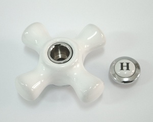

Can anyone tell me if the shower faucet handles shown in this photo will fit my shower faucet, also shown? Is this stuff standardized or do I need more information from the manufacturer of the shower faucets?

Those look like old American Standard handles and they look very nice.
Can't tell what make that faucet is in that picture.
Most handles are all different.
When shopping for replacement handles you need to buy a handle like the one that came with the faucet. Otherwise you probably will end up with a fitz-all handle and most plumbers don't reccomend that. I wouldn't let any one talk me into that...

There are at least a dozen different "standard" broach sizes ( that is the spline or groove area on the stem that the handle slips onto.) This is the reason handles are not generic, but usually fit only a specific brand.

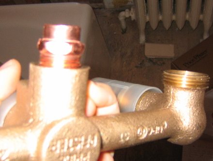

I decided to swap out the entire shower faucet unit. Even though I knew how many splines I needed for the handles, I couldn't find the right size stems to fit the valve. Now I've got this Price Pfister faucet and showerhead system and I have an unexpected problem.
I'm going to run copper pipe up from the valve to the showerhead and down to the tub spout. But, the problem is that I can't screw in all the way the threaded coupler that I'm going to solder onto the copper pipe. I'm not new to screwing in things. This puppy just won't go in any further than it does in this photo. This is not just finger tight, this is wrench tight.
I'm not sure what to do. On the one hand, if it doesn't go in any further, than it must be tight enough to serve my purposes. On the otherhand, I've never heard of not screwing in a piece all the way. As far as I know, there's only one size threaded coupler that I can buy to fit a 1/2" copper pipe, so I don't think I have the wrong size piece.

Your fitting looks about right. Remember that pipe threads are tapered. The proper procedure is to tighten snug by hand, then by wrench until snug. If you are talking about the fact that you can still see threads, that is normal. If a fitting went together so that all the threads disappeared, NOW something is wrong.
One thing, I do not see in the picture that you used either teflon tape or a paste-type thread sealant. If you did not, take it apart and redo.

Ok. So as long as the fitting is snug I won't worry about the threads sticking up. Perfect.
I didn't use Teflon tape because this was just a dry fitting to see if everything worked. When I install it I will definitely use Teflon tape.

Becareful if you use teflon and then solder . you are better off using pipe dope ,it can handle the heat better . Also, remember to remove the plastic stems,etc before heating the valve,,,you will have plastic mush if you don't .

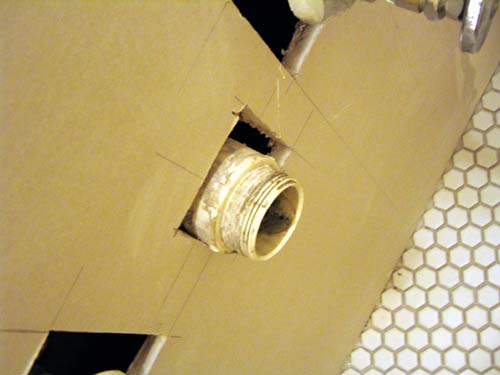

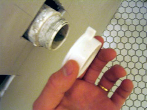

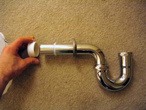

I'm obviously missing a piece here but I'm not sure what I want. This is the drain hook up for the bathroom sink. The stub-in pipe in the wall has a 1.5" threaded male PVC piece sticking out. I found a coupler that is 1.5" pvc threaded female, but I don't think this will work because when I insert the P-trap kit, there's nothing to really hold the chrome piece in there. Don't I need something to fit over the crome end and screw back into a different kind of coupler?
What am I missing?

The trap may be 1 1/4". You need a slip washer that is 1 1/4 ID X 1 1/2".
That will make it fit.
