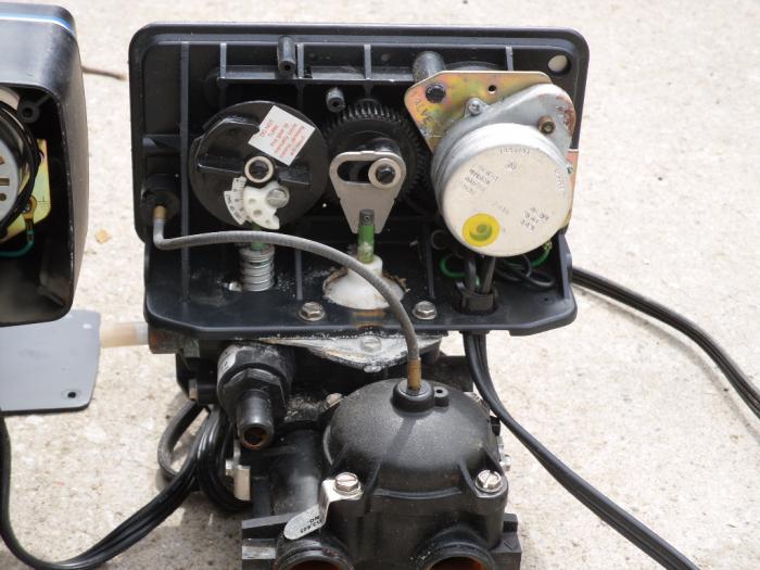

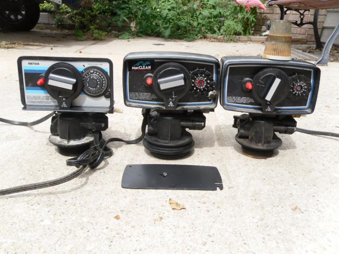

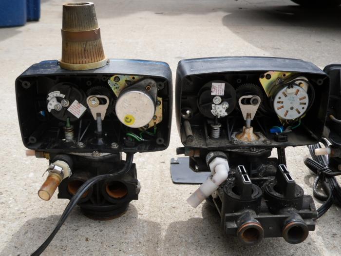

SAM_0865.jpgSAM_0866.jpgSAM_0867.jpgCan I retrofit a softner by changing the media and settings on the existing valve? I am replacing a failed MacCleens unit, I also have aquired 3 old softners One 3210 valve and timer, two 3200 manual timer. Also the maccleens unit has a 2510, but it leaks and needs to be rebuilt. Ihave two 9x44 tanks and 1 12x48 (old MacCleens unit)

All three that are in the photos are Fleck 5600 valves, two day clock and one meter and all three can be rebuilt.
There are a few things that would have to be removed to turn one or more into a filter valve... non softener valve ..
If you use the Maclean valve there is that collar that screw on to the valve but uses a clamp to hold it to the media tank, that will screw off if you are wishing to use it on a non Maclean tank.

That sounds like an old Fleck 2500, the body and the part that normally would screw into the tank are held by two screws.
Is that valve in the photo?

That is the timer wheel that is black, over on the motor that pushes or pulls the piston there is a cam with switches , what color is that??
I would go to 7 pins and then rapid rinse depends on black or white cam on that motor hooked with the piston.
