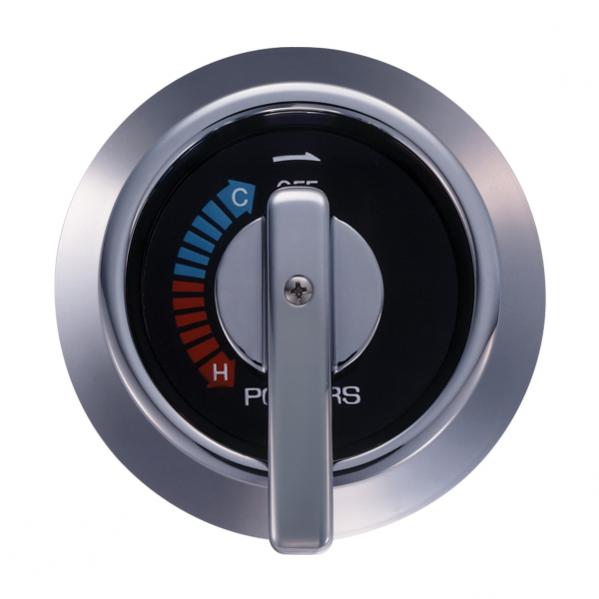

I am doing a remodel of my bathrooms and want to change the showerheads, spouts and control levers in my 2 full bathrooms. I brought in a few contractors who said we "HAD" to do all this extensive stuff and long story short quoted anywhere from 6-10k just for the plumbing (NYC pricing, ha!) This is a highrise building and doing anything with opening up walls is a pain and expensive!
So I then had the maintenance guy from my building come in since he is doing a bunch of work on the side for us (installing new toilets, light fixtures, vanities etc), and he said that it's NOT necessary to do anything with the plumbing, I can just change out the trim with any trim kit I find that I like.
So here is my question:
Currently the showers use these "Powers Hydroguard 410" lever controls 044.JPG042.JPG086.JPG085.JPG
He said they have a brass valve and he can supply any of the valves needed and any standard trim kit should work. I want to buy a mid-range Kohler trim set to replace these fixtures with. I know ideally it would be better to change out the whole shower body, but we simply don't have the kind of money it costs to do it right now.

Your handyman doesn't seem to have a clue about the valve and the trim for it.
You have to use the trim that is made for the valve in the wall. Either that, or change the valve in the wall.
What is standard, is the shower arm. That threads into a 1/2" female fitting in the wall, so any standard shower arm, or shower head will work.
The tub spout is also a standard 1/2" pipe thread.

I just checked and I found the updated version of those old Powers ones and it was over $400.00 just for the lever replacement.
So is there no Kohler or Grohe or nice replacement I can buy?
As for opening up the tile and replacing the valve, opening up the tile does not = opening up the wall does it? My building requires a 5k deposit to do anything that requires opening walls.

If your guy has done it, then let him find the parts.
That's not how it works in the rest of the world though. For the rest of us, you would normally find parts that mate up.
Manufacturers don't make parts that interchange.
I also can't use Toyota parts in my Mitsubishi.
The picture you posted shows a complete valve with trim. Can you buy just the trim?
And if you go to the Powers web site, you should be able to contact their tech support and they should know your options. That has to be a common question for them.

Well, you definitely can NOT just change out the trim with "any kit you like". That just doesn't work and if he told you that he is out of his mind. Now, Powers I think does make some kits to upgrade the 400. Check the Powers website, or find a large plumbing supply that deals with Powers.

You can use any POWERS trim that fits the model 410, but NOTHING made by Kohler, Moen, Delta, or ANY OTHER manufacturer will work. ANY "plumber" who tells you that you can get "can just change out the trim with any trim kit I find that I like", is NOT a plumber, regardless of how many years he has worked.

Jimbo, after speaking to the plumbing store you gave the contact info for (thank you) I was told that I am the LUCKY (ha) owner of a Powers unit that CANNOT be upgraded via any kind of trim. He said the new sleeker version of the 410 has a whole new valve and there's no way to just change the trim without upgrading the valve.

4. "replacing the valve" IS "changing the whole shower body". The shower body IS the valve.
