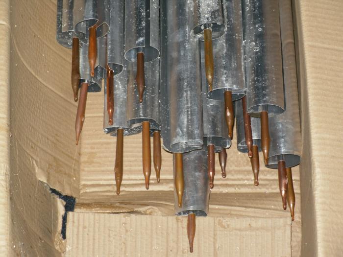

this pic shows what happens to evacuated tubes in the winters of the usa, you have to spec that they have alcohol in them or they will split at the bottom when it freezes outside. this pic is from a customer who bought the tube type and regretted it big time.

Hi
Not all vacuum tube solar water heaters use heat pipes,
The units I use have water in the tubes, anti freeze can be added as the unit is indirect.
I prefer the water in tube type because it increases the hot water storage capacity also as heat is drawn from the unit cold water will sink to the lowest part of the unit which is the vacuum tube and remaining hot water will be forced up into the storage tank.
Tony cssolar Spain
