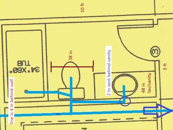

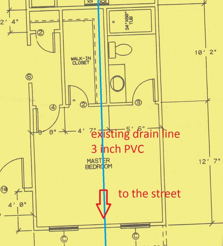

First little info on the current layout. The bath is 5 ft wide 10ft deep with a standard tub/shower, toilet and 46 inch vanity. The drain line runs from back of the house straight to the street. There is a 3 inch cleanout on backside of house. From cleanout the drain goes through the kitchen then runs about 4-6 inches behind the bathroom wall then out to the street. Just outside the front of house there is a 4 inch cleanout but I figure under the house would all be 3 inch. (???) I would just look under the house but it is on a slab. In the attic only one 2 inch vent runs to roof. It looks to be coming from behind the vanity. So my guess would be vanity is used as wet vent for entire bath.
That now brings me to part two. I am trying to find a plan that will minimize the runs and venting. My back will greatly appreciate me not breaking up entire floor. So I am going to upload couple pictures. The yellow will be current layout and the white the new one. I know there is probably a million ways to do this. I am just looking for a simple way. Here is some other info:

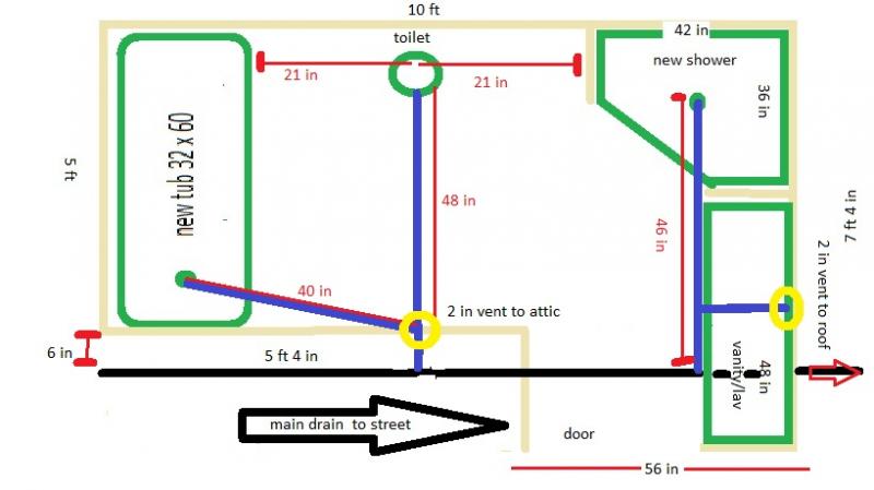

the reason I posted here is to get advice on how "you" would do it. I have a plan I drew up. I will post it here and see if I am on the right track.

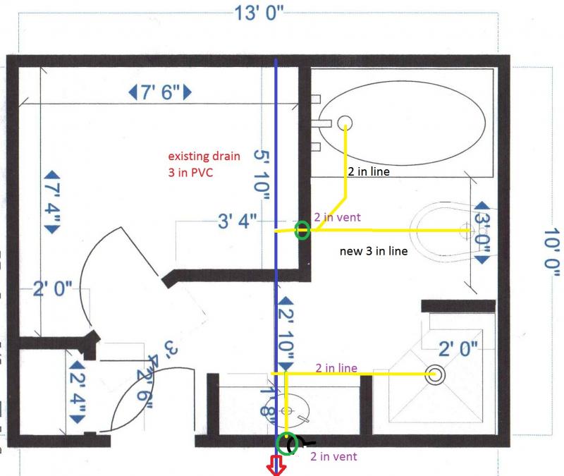

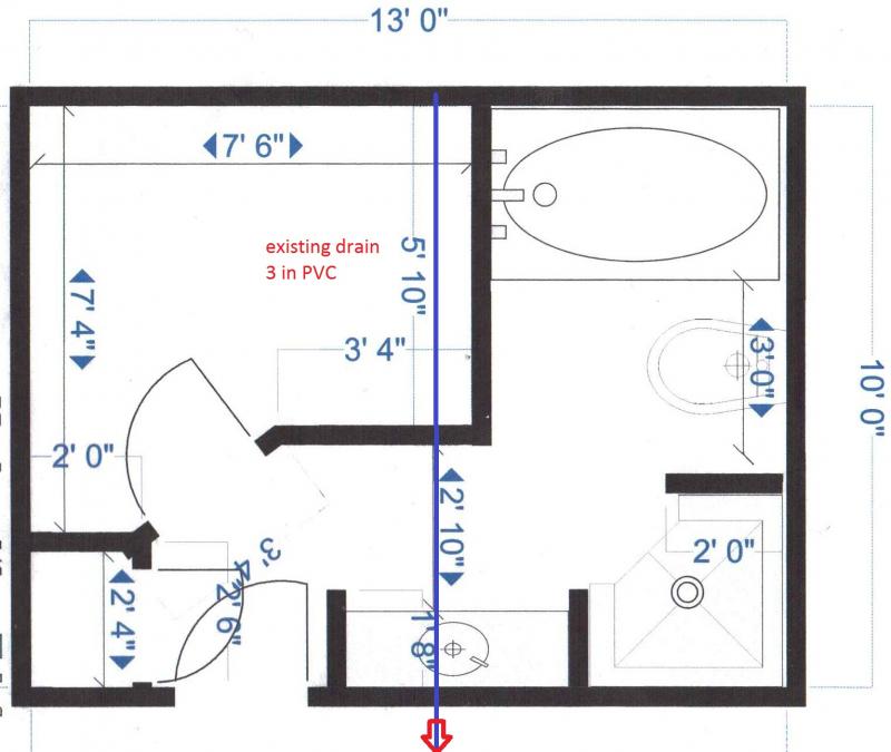

Maybe someone on here would be willing to tell me if I am even on the right track. Nothing is started. Nothing is finalized. This is the planning phase. Getting ducks in a row. You know information. :rolleyes:
I am just the kind of person that plans and plans (builds things in my head) a million times before I ever think of starting. Playing out ever step from every angle possible. Drives my wife crazy!:cool:
I am posting a basic layout plan. I know it is rudimentery but it gives the general idea. The other is proposed new layout.
I know exact fittings are not listed. But my plan was to use combo wyes at the main line, 3 inch PVC from toilet and all others would be 2 inch PVC. The yellow circles represent 2 inch vents tying together in the attic then to roof.
I will include the current layout (yellow picture) as told to me by builder. He wasn't sure of the exact layout but said this was pretty close. There is a 2 inch vent coming off the lavatory that should wet vent the tub and toilet.
Any comments or suggestions would be greatly appreciated.:D

Right track? Without seeing the construction, the framing, exact measurements and distances there is no "right track". The best you will get is good luck.
I would vent the toilet using a 3x2 combo, and after that, throw in a wye and vent the tub with a 2x1.5 combo looking up. Take those two vents and revent at 42"
On the lav and shower, the lav can wet vent the shower.
So in that drawing, i would have three vents coming out of the floor.
Or you can place a wye before the wall for the toilet, and use a 2" combo to vent the toilet, using one vent.
I would angle the 3x2 wye so that the tub is taken off above the flow line of the 3" pipe, and use the tub vent for the toilet.
I'm assuming you have fairly shallow pipes in the ground now, and can't stack your fittings like you could in a crawl.

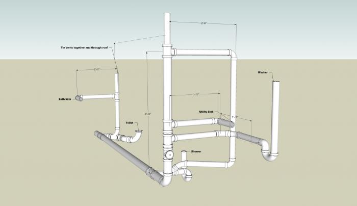

How about a drawing like below instead of lines on paper.

What your drawing shows and HOW you actually install the piping could be two entirely different things, so we would have to know how you plan to route the piping first. I have seen customers take a "perfect" drawing of a drain line, given to them by the city building department, and install a 100% "illegal" system using their interpretation of the drawing.
