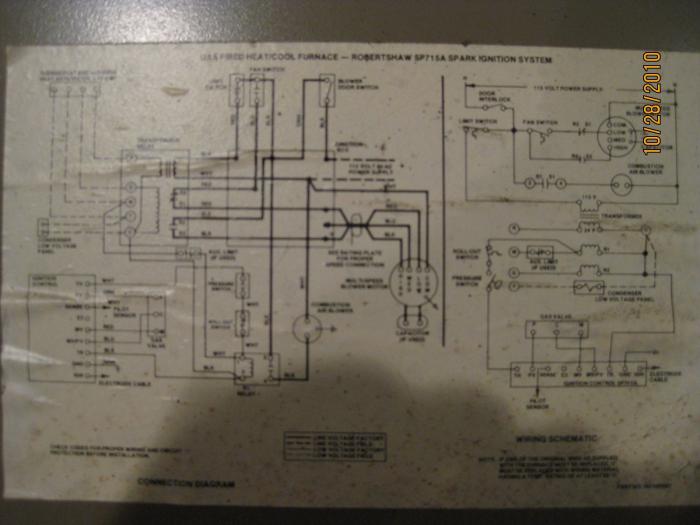

Can you post a schematic? Do you have a multimeter?

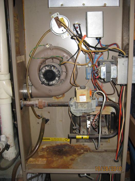

Sorry about the wait guys. The furnace does turn off after a couple of min. I could get my hands on a multimeter. I have added a couple of pictures.

The schematic is illegible but if it weren't there would be some crucial circuit test points you could check. My camera has a close up option but this same schematic may be online somewhere.
You should probably find out why your furnace housing is rusting. Maybe water is dripping from that blower housing in the upper left.
