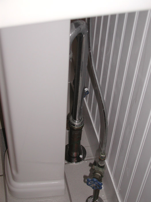

Here are some pics of our pedestal sink. I just replaced the old pvc s-trap and braided supply lines that were inside the moldy old vanity with chrome.
As you can see, the stubs through the floor are copper, not pvc like yours. I choose to see the scaley old copper as rustic, instead of unfinished.
Wainscoting, toilet and ct floor were also part of this project.

Thanks for the pictures. I think that looks great. If we could get as good a result I would be thrilled.
