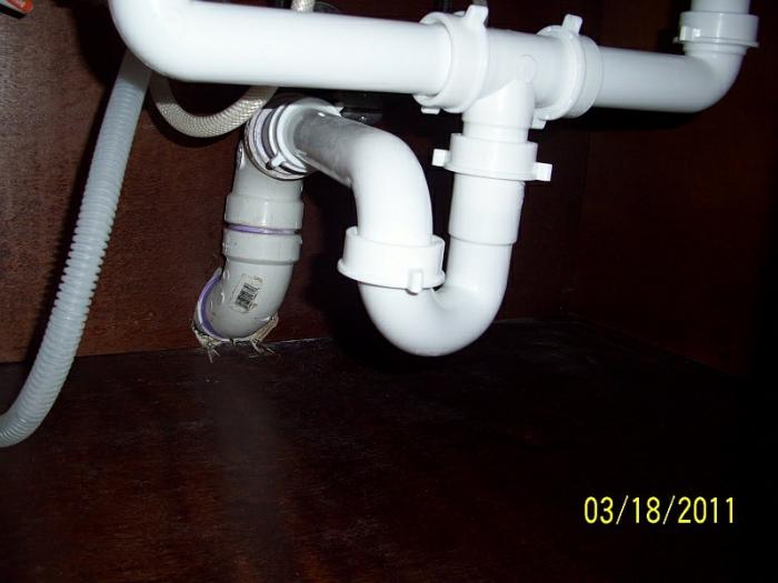

Just bought this house and want to add a disposer under the double kitchen sink. The "flipper" we're buying from moved the sink from across the kitchen and the new one isn't tied into the vent stack. Our home inspector said the nearest vent is seven or eight feet away...inaccessible and too far from the fixture to satisfy code anyway. He suggested we have a air admittance valve put in when we have the disposer installed. The under-the-sink drain plumbing doesn't seem to be well done and needs a makeover when a disposer's installed. I think that's an S trap they created in there.

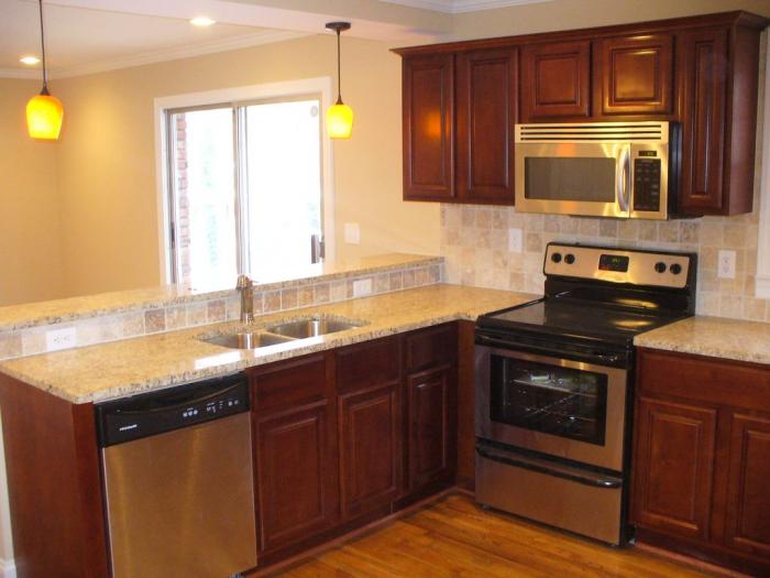

Dishwasher's to the left of the picture and the countertop is granite (tougher to cut in an above-counter AAV?) We'd like the disposer under the left side sink.
I'm not sure I'll attempt this, but whether we have it done by a licensed plumber or I do it, any suggestions on how, done right, it should look? I can post another picture if the "big picture" and "under the hood" views don't show things adequately.
Thanks for any advice.
Sounds like you may be confusing an air gap (that installs above the counter - well, actually through the counter) and an AAV. If you did use an AAV, it would be as high as possible under the counter where you could still unscrew it to replace. There a lots of diagrams of other projects where this has been done to go by.
Yes, that does look like an s-trap. Even if it had a loop vent (which would pass code most places), it's still not installed properly.
The disposal will have a DW inlet port, you can use that. You need a baffle T on the part connecting the two sinks to prevent the outlet of one from flowing to the other sink. The disposal acts like a pump, and without that, you'll have problems.

Just for starters, everything will have to be redone. The drain outlet is too low to connect a P trap and avoid the S trap like you now have and you must have a vent. Frankly, I think you'll be time and money ahead to hire a plumber to do everything that needs to be done to make this a legal installation.

The kitchen drain in the wall is supposed to be 2". The vent and the trap arm can be 1.5" The vent comes off at the trap arm height. In this case, at least install an AAV inside the cabinet.
Many places require an Air-Gap for the dishwasher. At least high loop the drain hose before draining to a disposer or a waiting tee.

Realized I'd never posted to say I hired a plumber to handle the mess under the kitchen sink. He installed the disposer and high-looped the dishwasher drain tube before tying into the tee. Also put a Studor Mini-Vent in there to provide the missing venting.
We're on a septic system and our plumber did not tie the dishwasher drain into the disposer. The gunk that comes off the dishes and kettles goes right into the drain line where it exits the disposer and then out through the DWV line. OSince we're on a septic system, should the dishwasher drain into the disposer so everything's ground up before heading below deck to the septic tank?
