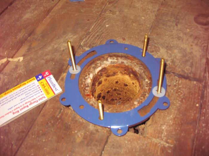

Saraugo: I'm having a same problem as your project and wonder if you can tell me a thing or two. I'm raise my floor (tile) to approx 1" above the esisting flange(cast iron). The CI have no holes other than the two johnnybolts on two side. I brought this PlumbestC85-000 ring(blue) see attachment pic.
Iplanning as shown to attach the johnny bolts to the existing CI and attach two others johnny bolts thru two holes of the blue ring only. The 4 ears outside othe blue ring will attach the ring to the subfloor.
My plan is to attach stack ree of the SiuoxS86-R extender ring that you uses on my blue ring. I will put a nut on the last extended ring and wax ring over that. Think this will work?
Silcone: What did you use? brand type
I plan to coat the 4"hole of the three decks with silcone so to prevent and creeping of water between the decking. What do you think?
you can notice the two johnny bolts on top and bottom that for the spacers to attach to.
