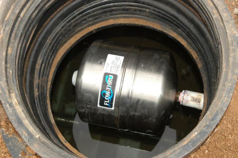

Mounted inside my 1750 Gallon Water Cistern is the Grundfos SQE pump and a small 4 gallon pressure tank (Flexcon FT18). I have been told by well & pump guy the pressure tank should not be mounted in the cistern and horizontal isn't good either. I would like to move it to a different location but can't find installation instructions on the web.
Currently the 4 gallon stainless steel pressure tank sites inside my main water cistern attached in a horizontal position about 4 feet directly above the SQE pump.
Have been told the purpose of this tank is to provide some (electrical term) capacitance for the pump as it turns on and off while providing water pressure to the house. Flush a toilet get a drink of water the pump would just click on then suddenly off and that i have been told is bad for the pump. So the purpose is to be a bit of a spring so the pump doesn't surge. (this is what I have been told its reason for existence. )
Question #1 Must this 4 gallon pressure tank be as close to the pump or can it be anyplace in my entire water system as long as no check valve is between the pump and the FT18?
My thinking is that if the tank was moved from inside the cistern and placed in the garage but on the same cold water line it would perform the same action. There are no check valves between the pump and my water heater in the garage. Just the house with all it's water pipes and sinks and toilets. However if placed in the garage then the pressure tank would be basically the last thing on the line before the water heater.

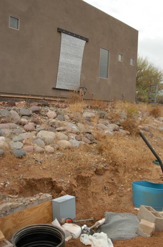

Question #2, If I cannot or should not mount it in the garage, (other end of the house) can I mount it about 15 or 20 feet from the pump and tank. I have a good clean location and it would work well. It would be the first thing on the line from the pump before the house. It would be moved from inside the water tank and be outside in the elements, but I would put a small housing over it to protect it.

Image called FT-18-post.jpg is the image of how the tank is mounted now.
Image called FT-18-Place-POST.jpg is the distance from the tank to a window where I would place this thing if my Garage idea isn't good.

Those pumps can be installed in wells hundreds of feet deep, which makes them hundreds of feet from the tank. I think the important thing is to keep the pressure tank and pressure transducer together.
Scott Stemen
Arizona
Forgive my stupidity. What is a transducer? you mean the pressure sensor that is about 12 inches from the tank.
Valveman
Cary Austin
14,633
1,304
Lubbock, Texas
cyclestopvalves.com
Yes and the transducer “pressure sensor” needs to stay within 12” of the tank. The whole idea of the flow through tank is to keep the water in the tank from getting old, stale, and contaminated. That is because with those variable speed type controllers, there is no pressure bandwidth to allow the use of any water from the tank. The water that is in the tank stays in the tank forever. The water in the tank would get nasty, and the next time the power goes off, the tanks air charge would shove this nasty water into the house.
So the “flow through” nozzle at the entrance to the tank circulates water inside the tank as water flows past it in the mainline. This hopefully keeps the water in the tank from turning green. Since the tank cannot be used to store any water, the pump must come on every time you crack a faucet open, even for just a small glass of water.
This makes the main purpose of the pressure tank to cushion the “pressure sensor”. The pressure tank and “pressure sensor” need to stay close together so the pressure tank can cushion the sensor from the pulses in pressure that happen when the pump starts, stops, changes speed, or when you open or close a faucet.
It is good that you are moving the tank and “sensor” out of the cistern tank. Because the place where the sensor is attached, is the same place you will need to install a regular 40/60 pressure switch when the CU301 controller quits working. Yours has already lasted longer than normal, probably because you don’t have any outside watering, and the pump apparently doesn’t get a lot of use. The age of that CU301 controller means that it is probably about the fourth of about six versions produced. Which means it will revert to cycling the pump on and off like a regular pressure switch, and will do this about 500 times before it shuts down and alerts you that the CU301 and motor have lost communication. This is usually when I get a call and show people how to replace the CU301 and “sensor” with a regular pressure switch, and where to add a Cycle Stop Valve to produce the constant pressure and keep the pump from cycling. Sometimes they don’t start looking for an answer until they have replaced the CU301 three or four times, and are very angry by the time they call me.
