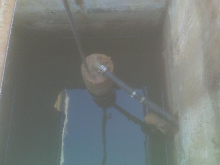

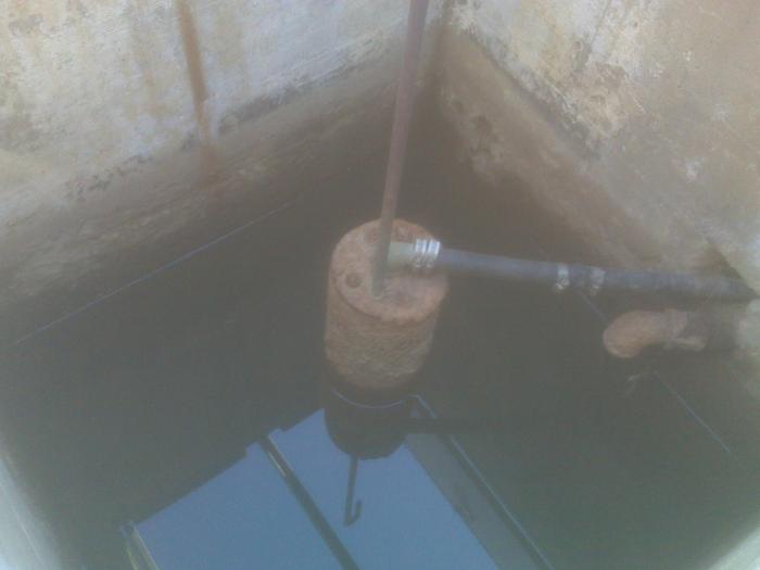

Drop Pipe
I attached pictures of my current setup. Is the drop pipe threaded?
Am I correct in assuming the following steps:
1) Remove the drop pipe
2) Remove the copper discharge 1/2" line seen in attached pic
3) Remove the cap
4) Insert pitless adapter and re-attach drop pipe
5) Extend Casing and install new cap

Wow, I would be very worried about that water sitting around my casing like that. Contamination could easily get into your well.
Your steps may or may not be correct. A lot depends on what kind, type or brand pitless you are going to use.
Where does the 1/2" pipe go and what does it connect to or what does it do? I would have thought it was the wire from a submersible pump, but I'm not even sure you have a sub.

The 1/2" copper pipe extends up about 2' and then has a 90' elbow at the top. WHat type of pitless adapter do you recommend? Regarding the water around the pipe, the water is always about 1 1/2 feet deep.
Sammyhydro11
708
Massachusetts
That 1/2" pipe is a vent for the well. What you have is poly pipe that goes through the well seal, into the well, and on the end is a foot valve. Extending that well casing is not an easy task for a DIY and should be done in a professional manner so that the joint or the pitless will not leak. Once it is done correctly, that pit should be filled in with clean material. Extending these well casings in the summer time mounts to 25 percent of our work. We either have a certified welder extend them for us, or we use a casing extension adapter and bring up the casing with 6" PVC pipe. Do not by any means extend your well casing using a fernco coupling, they are bad news. Merrill makes that extension adapter. http://www.merrillmfg.com/product/02-PitlessUnits/Pitless-Connectors/features.html

You do not have a pitless adapter now, the weight of the drop pipe is supported by the elbow resting on the sanitary well seal, the part with the four bolts.
