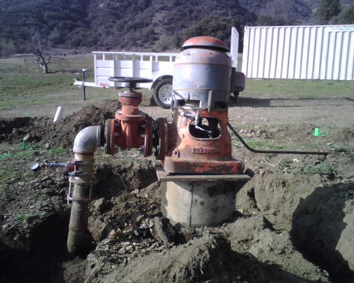

Here's a decent picture of the well. The concrete you see around the casing only goes down into the ground about 3 feet below the steel plate. I siliconed between the bottom of the plate and the top of that concrete. I plan to seal the discharge head to the top of the plate this weekend. You can see how the discharge head is wedged up at the front to align the motor and that space opens up directly to the casing as well. Once I seal that then the pump will be fully sealed from the atmosphere. I will put a screened vent cap on the sounding tube to allow air flow in/out of the casing upon start/stop.
I will then install a minimum 6'x6' concrete slab around the well and build a building (that is if we ocntinue to go the route of using this well).

Ok, so I went up to flush the well again yesterday afternoon and the water was much clearer than the previous days flushing. I assume this was because there was not a bunch of CL2 sitting down the hole over night.
Everything was looking good until I realized I had not turned the oiler on while the pump was running. If you look at the picture there is a 1" dia verticle cylinder on both sides of the motor. One of them was empty so I began filling it with the oil that my father in law has been using in it for eons (30w motor oil). This thing just sucked everything I poured into it even though the little cylinder can probably only hold maybe 8 oz.
From what I can tell these oil tubes (reservoirs) feed the motor and bearing that the pump shaft comes up through. Is there any direct connection between these cylinders and the actual water ? The reason I ask is because I started seeing a little oil slick on the water that was being flushed out onto the ground which seemed obvoius to me that there was some kind of contact/connection between the oil I just put in and the water coming up the column and out the discharge.
-Should this oil be a special food grade oil instead of motor oil?
-When the oil goes from the little cylinder, through the copper tubing and into the bearing around the shaft does some of it drip down the entire shaft down in the column?
-Should I be concerned about this happening?
-Does it indicate a problem/malfunction with the well?
-How is this avoided in other verticle turbine wells used in potable water situations?

Some submersible turbines have oil filled bearings. They are fed with a tube from the top kind of like your describing. I have only seen one of these and the inside of the well had many feet of oil floating on top of the water. Needless to say, these things do leak oil.
Sounds like that's what you have and if you don't keep adding oil, the pump bearings all the way down will start to wear out quickly.
I had to hire a guy with a camera to map this 8" well. The poor guys truck was dripping with oil when he pulled the camera back out of the well. It was over 600 feet deep and the cable the camera hung on was covered with oil as it went back on the spool in the back of his box truck. The entire floor of his truck was oozing with oil. I suspect he spent the rest of the week at the car wash.

I can see the sight glass for the oil dripper in the photo. This changes everything. An oil lube turbine has a tubing over the shaft all the way down. Some of these tubes are brass bearings and others are wood lined. Either way there is a drain hole in the bottom of the oil tube. This lets oil drip out the bottom as the dripper is adding it at the top. I use to have to go around and check these drippers when I was a kid. They need to drip about once every 10 or 20 seconds. Brass bearings will lock up quick if the dripper stops. Wood lined tube is more forgiving as the wood soaks up the oil and won't lock up as quickly if the dripper stops.
Water quality is going to be a problem. What you will find when you pull the pump is the oil is floating as Speedbump said, and will be all over the column pipe and well casing. I have cleaned these type well up for domestic use but, it takes a lot of work. You can add certain soap and chemical to break up the oil and help flush it out. Then you need a bailing truck to clean out the well. There will also be a few feet of black muck in the bottom of the well where the slug has settled over the years. It will take a lot of bailing and test pumping to get this well cleaned out. You may never get rid of the oil completely.
Most people have switched to vegetable or mineral oil in recent years. But the years of that regular 30 weight dripping is going to be hard to get rid off. Most wells, including Municipal wells, now use a water lube turbine. There is no tube around the shaft. Every 5' or 10' there is a spider with a rubber bearing. The water flowing up the pipe lubricates these bearings, as there is never any oil allowed close to a municipal well.
I would switch to a vegetable oil and only use this well for irrigation. Then I would drill a new smaller well just for the house. I would drill the new well as far away from the old well as possible.
You will also have problems trying to seal a turbine well head but, that doesn't make much difference if you are pouring oil down the well anyway. I wish I had better news for you. You will probably spend more trying to clean up that well than it will cost to drill a new one. Would have been a different story if that were a water lube turbine instead.
