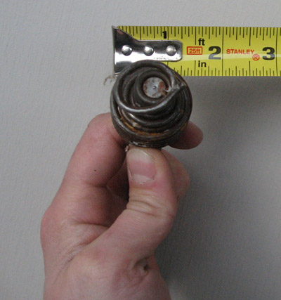

Thanks for all the great feedback. I'm thinking, based on my options, I should have them pull the toilet and use their heavy duty auger as the first step. I'm not sure what sending a camera down would do for me other than being cheaper? If the camera shows a clog then it would have to be augered anyway. I did buy a closet auger at ace hardware that was roughly 3 ft long and stuck that down the toilet with no results. But I guess if the clog is further down the line that would not have gotten it. I don't have the skills or time right now to pull the toilet to auger. The guy kind of scared me by saying it may be that the plumbing was installed wrong or that there was no venting. If it was this serious I would think I would have seen something years ago. Thoughts?
