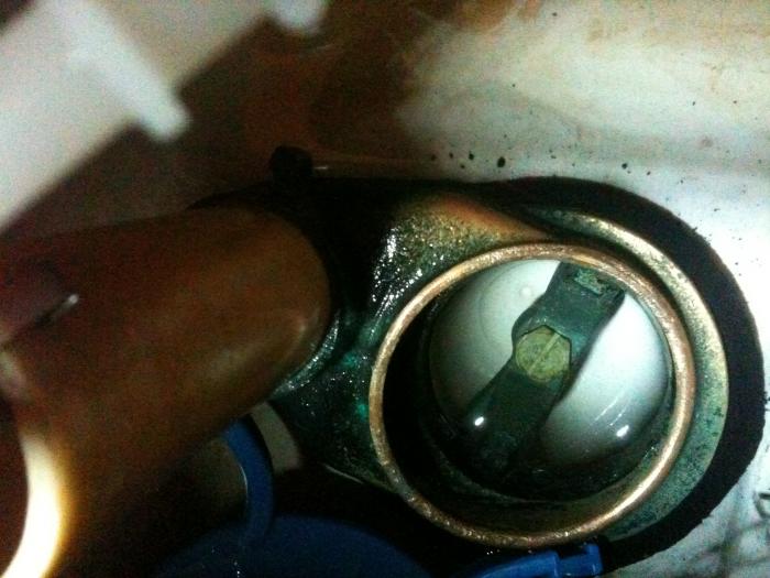

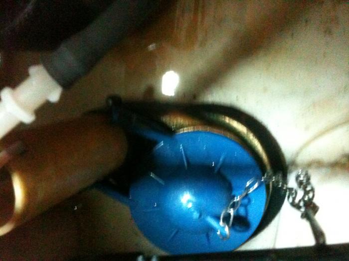

Hi,
Thanks for the suggestion but I couldn't find 3 bolts that you mentioned. I'm attaching couple of photos of flush valve. Would appreciate if you have any suggestion on replacement part and/or how would it cost.

Thanks. I definitely noticed the surface is not smooth. Not sure what caused it. Since it is a one piece toilet there are no nuts below the tank.

Yuuuuuuuuuuup.... the seating surface is pitted. The big screw down there is what will remove the flush valve. You might even get away with dressing the seat with some emery.
