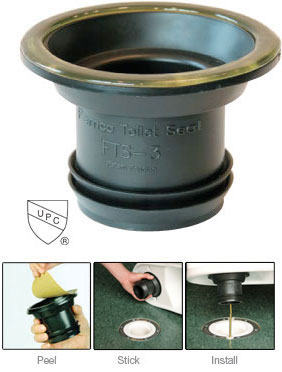

Hi,
I'm interested in installing a neoprene seal in place of the classical wax ring. The neoprene seal is attached to the bottom of the toilet discharge through some very sticky rubber glue applied to the seal by the manufacturer. It extends about 3" from the toilet outlet.
Anyone use these type seals?

My question to you is why? Wax seals have been doing a excellent job for years.
John
If the toilet rocks in the least, the wax ring will not maintain a good seal. With the type you showed, if the inside of the pipe is not nice and clean and smooth, it will also leak should there be a backup. If the toilet is not set perfectly centered, you can distort the seal, and it might not make good contact all around.
The toilet must be rock solid once set onto the wax seal, and then, if you follow (most) local codes and also caulk around the front 3/4 of the toilet, it will remain where you put it and not leak. The caulk keeps crud from dripping down or running underneath plus it helps hold the toilet in position which aids the bolts in holding the toilet in one place, protecting the wax ring.

I have used this model (fernco Waxless) and can report they work great.. :) However you may want to limit the use to new toilets... The weak link is the glue / adhesive adhesion to the base of the toilet bowl. If wax seal was previously used, the adhesive will not stick unless ALL the wax seal is removed.. I did this once using gasoline Kind of dangerous Make sure it is outside in well vented area.. The Fernco adhers so strongly the toilet can be removed repeatedly and reused.
Make sure you get the right size.. There are 3 different sizes... one for going inside a 3 inch pipe and one for going inside of a 4 inch pipe.. there is also one for going into a flange put on a 4 inch pipe.. check this out carefully..
The advantage of this waxless is that they don't leak! Even if the toilet wobbles.. They are also ideal if the flange is not installed on top of the floor (you don't have to install extension rings) Disadvantage .... if the flange is too high you cannot compress them lik a wax ring can.
I recommend the Fernco brand .. There are other brands that i have no experience with. The fluidmaster and other brands are a seal rather than a plastic pipe (like the Fernco) that extends down the flange.

My limited experience with these has been positive. The only suggestion I would make is when installing them, disregard the instructions and the little cardboard box. Put the seal on the bowl first, then lower the bowl and seal onto the flange.
