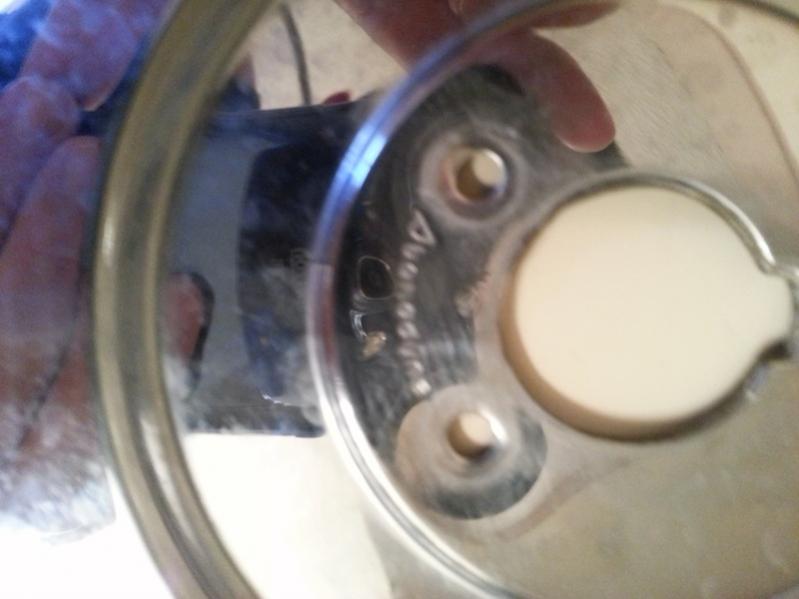

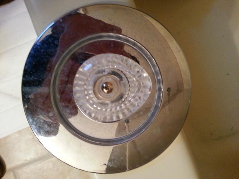

I have a home that was built in 1984, and now I cannot find the brand to the shower to replace the trim kit. I got an estimate on replacing the shower valve, but that was way too expensive. I have to believe I can find a trim kit that matches this one. Any help? Or does anyone know where I can research to find this?

You have the older Moen Chateau shower trim. All hardware stores carry this trim.
This Moen is from 1978
The cartridge on the left is a 1200 which is still a good replacement. I normally use the 1225 on the right.
They make a T473 trim with a crystal handle or the TL473 with the lever handle.

There are 4 basic Moen valve/trims : Chateau teardrop shape handle, flat plate ( this is yours ); Legend round handle, bowl plate; Moentro, teardrop handle, bowl plate, screw holes different; Positemp..larger teardrop handle, plate similar to Moentrol, but handle and stop tube diameter larger.
You should stop doing business with any store which cannot supply all four of these VERY common parts.

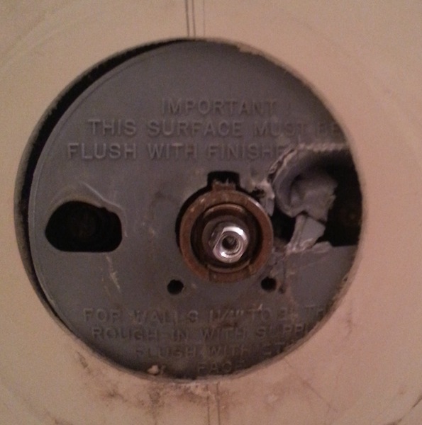

Also, how can I tell whether Chateau trim kits will fit mine since apparently mine is push-pull? Most of these don't say! I wish I knew more about this stuff!

http://www.moen.com/consumer-support/faq
you have a standard, non pressure balanced valve.
A recent innovation now makes it possible to retrofit Moentrol trim to standard valves. Service kit number 145058 (shown below) can be ordered to make the change. (from the above page)
edited: you have the standard valve, not the posi-temp one i thought it was.

When you want to replace trim for a valve which has been out of production for probably 10 years, your trim options become very limited. Chrome is in. Maybe some brushed nickel, the second most asked for trim finish. Any of the bronzes.....good luck, but Danco or one of the other aftermarkets may even have that one.
You will likely NOT be able to use a bowl-shaped Moentrol trim. Your valve is too close to the finished wall surface. But worth a try.

There is some gray plastic on top of the valve. I assume that was to make it flush with the finished shower. Do I need to remove that gray plastic before attaching the service kit adapter to the valve? Or does the adapter go on top of the gray plastic?
The gray plastic is there to prevent the tile guy from going right up to the valve. It can be thrown away. It serves no purpose now.

Its also a thin wall mounting bracket/support. It stays on the valve and supports the fiberglass from behind. Sounds crappy.....yep I agree. LOL
