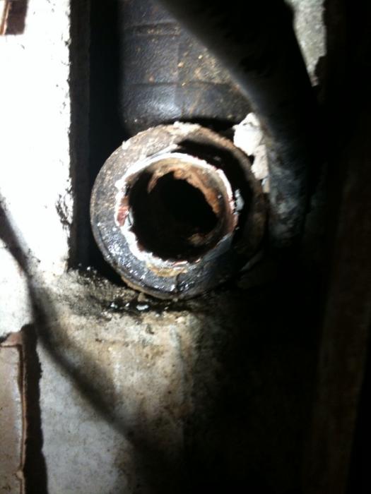

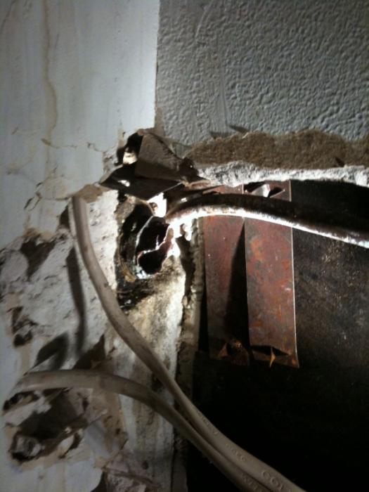

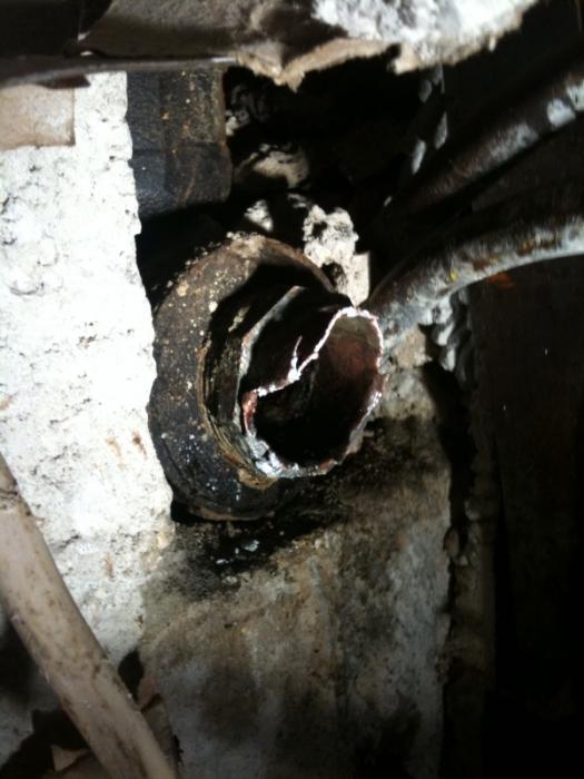

I have a Cast Iron Vent Stack that the Kitchen sink assembly connects into. The problem is the horizontal drain pipe that connected into the sink was cracked next to the vent stack connection. I can not remove the threaded nut that attached the original horizontal pipe (took the broken pipe out but not the nut) to the vent stack. It is tucked into a concrete block wall and the pipe wrench can't get a grip. Any suggestions?
I have tried penetrating compound....Attaching a pvc pipe with epoxy. I put a torch to it but no help. I'm out of options. I've attached some pics.

It looks like a trap adaptor which used to be soldered in. You can use a sawzall or hack saw blade and cut out a section of the threaded piece from the inside. Put the saw blade inside the fitting and cut straight down through the threads until you hit the cast iron. Then move around about a half inch and make a similar cut. Then pry out the little piece you just cut and you'll be able to spin out the rest of the adaptor.
33,603
1,042
pipe
It is a solder bushing for a tubular trap. Remove the vestiges of the trap by heating the solder and pulling the piece out. Then make two cuts, about 1/8" apart through the brass and remove the sliver between the cuts. Then use a chisel to fold the brass together to close up the slot, and it will unscrew, probably by hand.
ilya
104
Akron Ohio
I'm not a longtime pro, but dcelites method has always worked for me. Make sure the two cuts are NOT a "pie wedge" or it'll never come out. I always try to do the opposite-my two cuts are closer together at the threads. Then knock it out w/ a chisel, and unscrew. Once or twice I've had to repeat the process on the opposite side of the fitting,cutting it in two. Then a tap w/ the chisel knocked each half loose.
