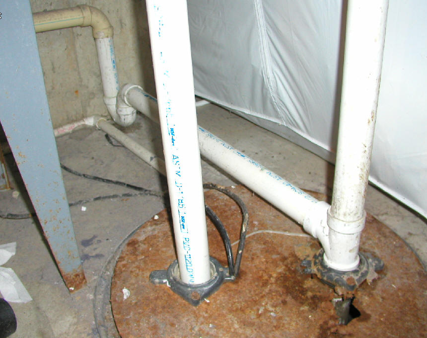

Attached is a picure of my current ejector pump.
Notice the 1/2" pvc coming in from the rear, that is a hacked way that someone is piped AC condensate into this pit. It is draining into the pit, with the lid just sitting right on top of the pvc. Obviously, this lid NEVER was closed or flush.
The left 1.5" pipe is the discharge pipe. The right is the inlet pipe that comes over from the Laundry sink drain. I *believe* the upper part of that pipe is for vent. It extends up into the floor above near the outer wall next to the Kitchen sink drain, but I do not see it under the kitchen sink.

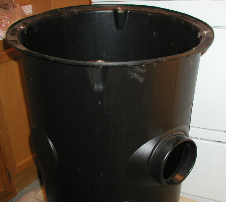

I will be cutting the rusted out lid off, pulling out the non-functioning ejector pump and replacing the pit and pump with a Zoeller M264 and 18"x30" pit.
I am looking for your take on how to fix this setup and make it standard. I will be replacing the discharge pipes with 2" DWV pipes.
