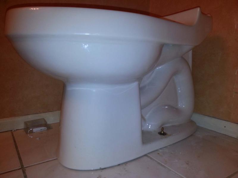

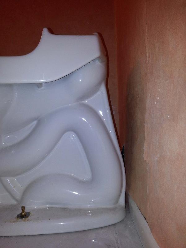

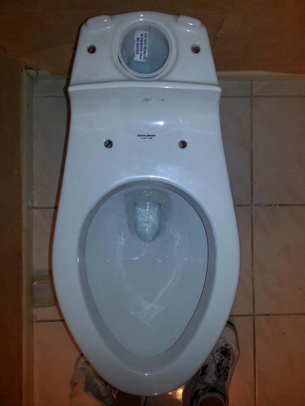

Back in 2009, I bought what I believed to be a Champion 4 elongated bowl and tank from Home Depot. The tank was in a sealed box. The bowl had a Champion 4 picture (with barcode) taped to it by an employee, and rang up as a Champion 4 bowl. It sat in my pile of "things to do someday" until today.

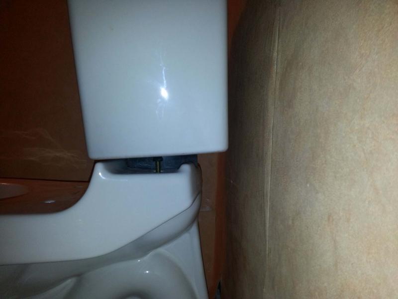

I got the base installed & bolted down, then discovered that the tank doesn't seem to mate properly with the bowl. The bowl has a ridge along the front and back where it meets the tank. The tank is MUCH larger than the bowl's tank footprint would suggest it should be. The two tank bolts, the gasket, and the water supply pipe all line up, but it just doesn't seem *right*.
At this point, I suspect that either the bowl was mislabeled (and isn't a Champion 4 bowl), there are different tanks for different Champion 4 bowls (and the nameless Home Depot employee paired up a bowl with the wrong tank), or American Standard decided to make some radical change sometime around 2009 that left new tanks incompatible with old bowls, but some evil decisionmaker at American Standard decided to keep calling it the Champion 4, instead of the Champion 4.1, Champion 4 (rev. 2), or the Champion 5.
So... do I have a mismatched bowl and tank, or do I just need to tighten the bolts until the tank's bottom rests firmly against the front AND rear ridges on the bowl, and just assume that there's SUPPOSED to be a half-inch gap instead of the tank neatly fitting into the bowl like a key into a lock? If they're mismatched, can anybody point me at either a bowl that's compatible with the tank, or a tank that's compatible with the bowl (preferably, something I can buy at Home Depot or Lowe's, ?
I'm attaching pictures of the bowl with the tank attached, as well as a few views of the bowl alone to assist with identification.
View attachment 19172View attachment 19173View attachment 19171View attachment 19170

I can't really tell, if you could show a picture of the tank it would be great. Another reason might be that the flange on the bottom of the tank is not completely centered with the bowl. I have a Champion 4 and could show you some pictures of what it is like there. I will do that shortly.
--GoKohlerGo
That looks pretty normal to me.
You may just need to center it over the gasket better and then tighten down.

You need the gasket compressed to make a good seal, so just straighten the bowl up so it's vertical (equidistant to each of the nubs in the front/back, and then carefully tighten the bolts evenly, side-to-side until it is just in contact (or very close) to all of the raised nubs.
