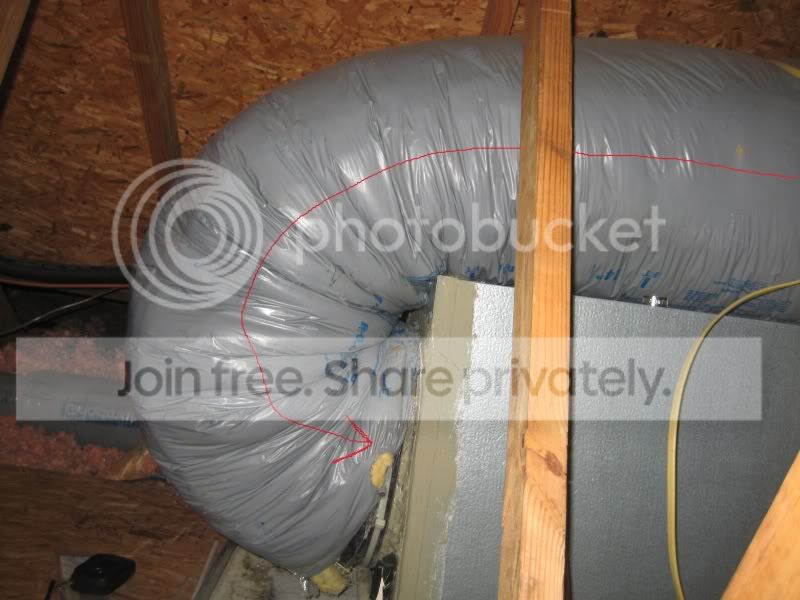

I need some advice from the experts, should I replace the duct work or the whole system?
I currently have a 3 ton Trane compressor and First Co hydro heat system installed in 2002, the house is ~1,500 square feet ranch. The indoor unit is placed in the attic with 14" return duct and 6" supply ducts. I'm in zone 4 mixed-humid. Heat load 34,000 BTUs and cooling 25,000 BTUs.
I was told the inefficiency was due to the system being too big, I need 2.5 ton and not a 3 ton. The supply duct is too small, I need 16" supply and not 14"; as well as the supply ducts being small.
To replace the system with a Trane dual fuel system it would cost $12,099. It includes gas/electrical lines, XV80 furnance, XL15i heat pump, hyperion air handler, XL900 t-stat and all new ducts (2.5 ton, 15 SEER, 80% AFUE). Without new ducts and use current ducts $8,000.

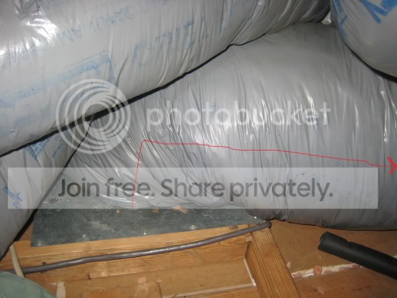

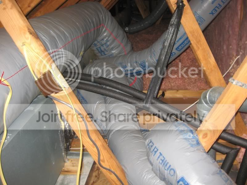

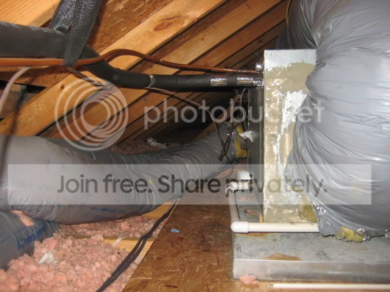

The builders placed a piece of sheetmetal on 2x4 for return duct
Return duct is under other supply ducts
Return duct
Return duct connection to air handler

Price out what a 2-ton 2 or three head ductless multi-split would cost before sinking any money into the duct-haired Medusa.
A 3-head Daikin 3MXS24JVJU or Mitsubishi MXZ3B24NA would blow the socks off any ducted system on whole-system efficiency in the cooling season, and can be cost-competitive with 80% gas burners for heating the place too if you're electricity prices are even slightly lower than the national average. (It really depends on your utility pricing.) I'd expect it to come in under $10K, maybe even under $8K.
The fact that the air handler & ducts are in the attic, above the insulation adds at least a half ton to the load numbers, and a 2-ton continuously variable speed compressor on a ductless system should be able to handle the whole thing, and if it doesn't quite make it during the worst cold snap of the season you have the hydro-air system as auxilliary/backup. If it's an open floor plan you might even do it with a single-head 2-ton mini-split in a house that size in a VA climate, but the ability run up to 3-heads off the same compressor is sometimes useful if you have a full basement or multi-story or lots of doored-off areas. (My uncle in WA, zone 4C heats his open floor plan 2-story with just a 1-head 2-ton mini-split and has never been more comfortable, but his sleeping loft/bedroom areas have better than average convection with the lower floor. He hasn't fired up the ducted propane furnace since.)
The better split systems have efficiencies approaching (and sometimes exceeding) geothermal heat pumps for whole-system efficiency, with none of the design risks.

Replacing the ducts may help, but if they're not meticulously sealed and insulated it could even go the wrong way rather than fix it. Designing the ducts to comply with ACCA Manual-D would be the starting point.

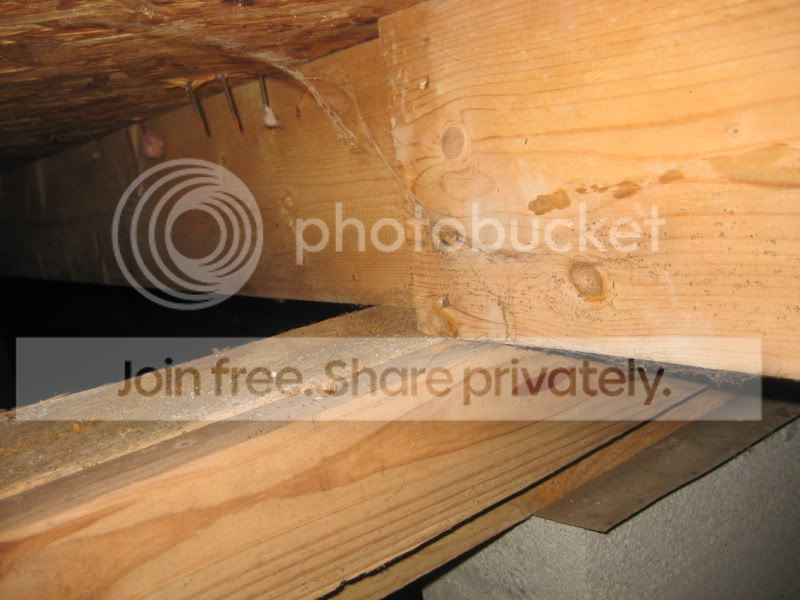

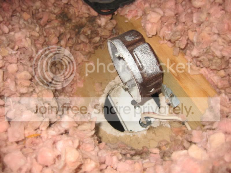

More pictures to give you guys an idea how this house was built.
Bypassed junction and straight into florescent lighting
Crawlspace: they nailed a 2x4 to a 4x6 so floor joist could have support
Hey, I think the same clown installed my bathroom lighting. I had to add junction boxes and mounting studs on several of mine when I replaced the dated original fixtures (el cheapo hollywood lighting bars.) The wires were just shoved through a hole that appears to have been made hastily with a screw driver. The fixtures themselves weren't even properly secured to the wall.

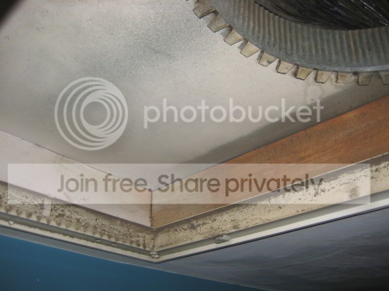

More important than the insulation, try AIR SEALING. Looking at how the place was built, fixing all the air-leaks you know about first, then hiring an air-sealing & insulation contractor to do the rest with blower-door testing & verification and IR imaging would CERTAINLY be cost-effective. It would lower the heating & cooling loads and increase comfort to boot!
The dust-darkening of the insulation around that hole in your ceiling at the light fixture is evidence of the massive air leakage at that point, and that's probably one of hundreds of mid-sized holes in the pressure boundary of the house.
