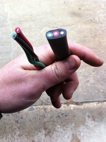

I posted this in another thread, but it's relevant here as well.
just so everyone knows.. all submerisible pump cable is not made the same. on the left is regular twisted sub cable, on the right is sub cable in a jacket. I don't know much about PE, but if rubbing wires was a common issue.. I would be sure to only use sub cable in a jacket.
