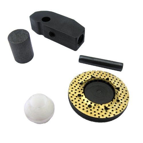

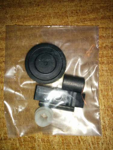

the ballcocks can hum and vibrate and literally get so bad they can sound like a jackhammer going off....
This happens because the rubber diaphragm in the brass ballcock fill valve has reached end of life. The rubber has hardened or deteriorated, and the pressure from a float, no matter high tide the tank level can be set, can no longer press down to seal the rubber diaphragm on top the fill valve's spout to shut. When the rubber diaphragm is working properly, it is quiet as expected.
Fluidmaster does sell a rubber diaphragm, but it is only for Fluidmaster fill valves, it has a hole in an extruded nipple and will not work on the older brass ballcocks that want a very flat disc diaphragm.
What you may need is a very hard part to find: "Crane Ballcock Repair Kit". When I was restoring my circa 1950 vintage Eljer toilet, I didn't want to gut out its 60 year old brass ball cock valve, it looked like it could work another 60 years, they are much quieter than modern plastic fill valves. And the sound of 6 Gallons per flush just sounds sweet my ears. The availablity of aftermarket parts is proof there is demand for them. You certainly won't find it in any big box stores, but if you are patient you can mail order it.
Equivalent parts include:
Jagplumbingproducts Part No. 18-034
LASCO Part No. 04-7087
